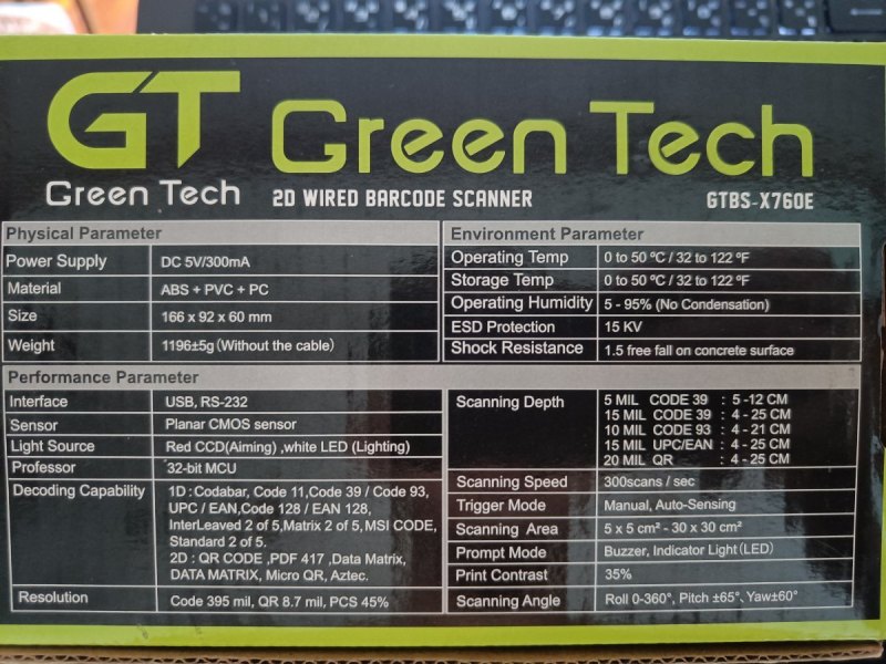

Hi, I am new to loyverse and currently testing to use in my store. I bought Green Tech GTBS-X760E barcode scanner and used it for testing.
When I filled the barcode of the items under each Item with that scanner, it wrote the numbers after scanning the barcode.
When I tested about selling in the Sales menu, the barcode sounds but the items are not put to the Ticket (Cart).
May I know it is because of the barcode scanner issue?
I have read the scanner's documentations that supports USB and RS-232. I attached the specifications just for reference.
Thank you.

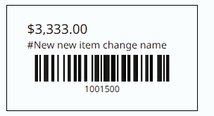

Usually, when a barcode reader reads a code, the reader adds “Carriage Return” (="CR", ≒[Enter key]) at the end of the number.
Example: When a barcode reader reads the barcode below, it will signal “1001500CR” in real.
Could you check if Carriage Return is activated on your barcode reader?
