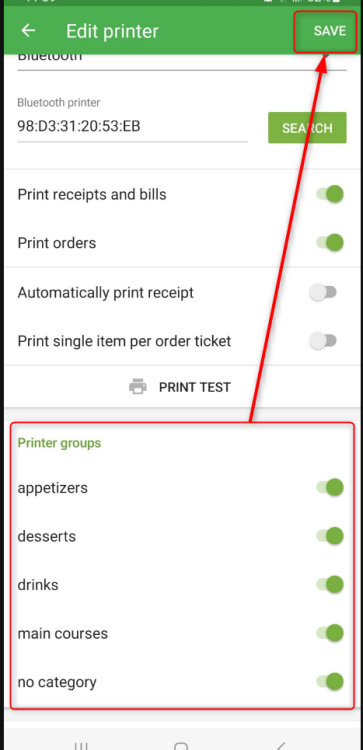

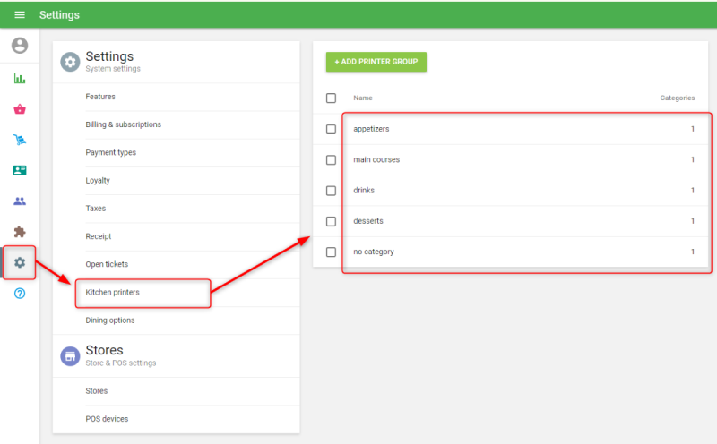

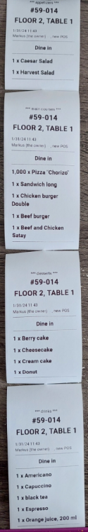

Georg Posted February 11, 2024 Share Posted February 11, 2024 Hello As the workaround, you can try this way on your kitchen printer/ kitchen display app: You can print different categories (starters, mains or desserts) of items on separate kitchen tickets if you assign them to the different kitchen groups. For example: Then, please activate all the printer groups in the kitchen printer settings in the POS App: Now, when you create an open ticket, the system will print all these tickets automatically one by one (starters, mains and desserts: Link to comment Share on other sites More sharing options...
