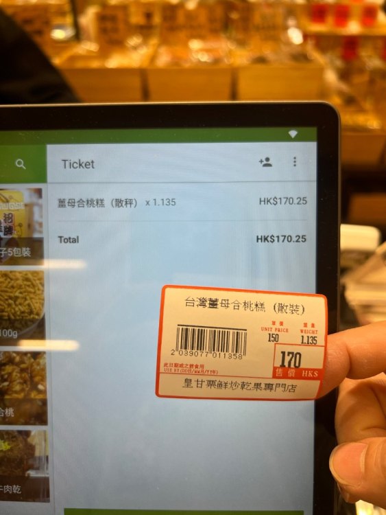

Could you make a few photos with the examples to see how the decimals are printed on your weight-embedded labels, please?
Hello, regarding the product in the attached image, the selling price is $150 per kilogram. When the weight is 1.135 kilograms, the price is $170.25 (150 x 1.135 = 170.25). Therefore, I would like to ask if it's possible to remove the 0.25 part and only display 170? Thank you so much! IMG_1538.thumb.jpg.0ce04670ea7d33b9fda57393434ba99f.jpg
The rounding is applied only after you press a CHARGE button and choose the CASH payment type.
