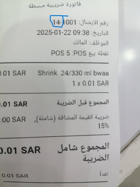

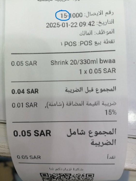

POsksa Posted January 22, 2025 Posted January 22, 2025 Can anyone please help me with this matter i have 9 employee and i added 7 pos device and i need to maintain the serial to 8 & 9 but i cant it mistakenly come with pos 14& 15 can i make it 8 and 9 ???
Georg Posted January 23, 2025 Posted January 23, 2025 On 1/22/2025 at 10:02 AM, POsksa said: Can anyone please help me with this matter i have 9 employee and i added 7 pos device and i need to maintain the serial to 8 & 9 but i cant it mistakenly come with pos 14& 15 can i make it 8 and 9 ??? Hello It is not possible to change the first value in the receipt's number. Each new POS that you create in the back office will be shown in the receipt's number as 16, 17, 18, .... . Even if you delete the POS devices in the back office, the new POS devices will continue the sequence numbering.
