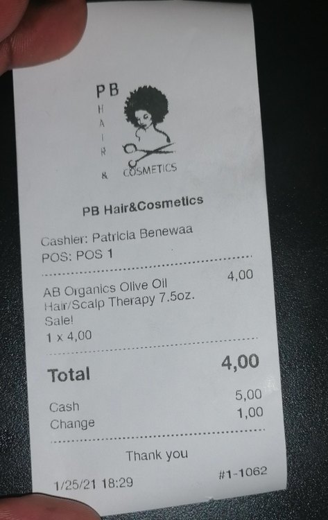

pbhair Posted January 25, 2021 Posted January 25, 2021 Please When I try to print something my receipt comes out with this weird symbols(see attached). It doesn't always print like that (see attached a picture of how it normally has to be). Please can you help me out? Greetings PB Hair&Cosmetics

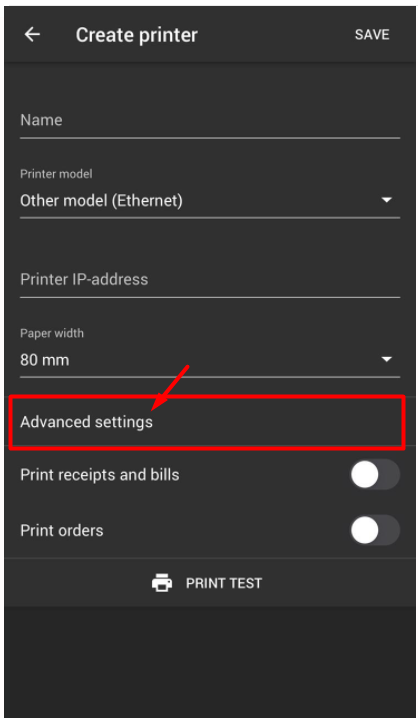

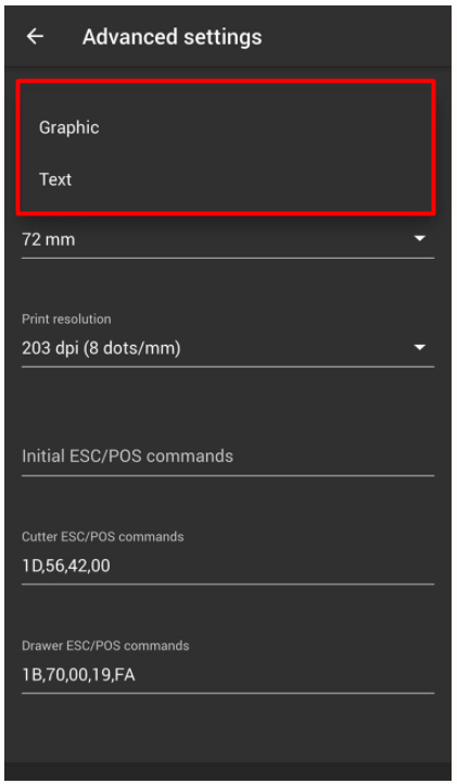

Solution Mia Posted January 25, 2021 Solution Posted January 25, 2021 Hello, You can try to change the print mode that you have selected in the Printer’s settings. For this, you need to go to the POS app->Settings->Printers-> Click on the name of your printer ->Go to Advanced settings and change the Print mode. Save the changes and try to print a receipt again. If this doesn’t help, it means that unfortunately, the printer you are making use of is not compatible with Loyverse POS app. If this is the case, we strongly suggest you to use a printer from the list of supported printers. The printers in this list have been tested and we can guarantee that they will work properly with Loyverse POS app. 1 1

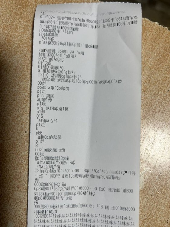

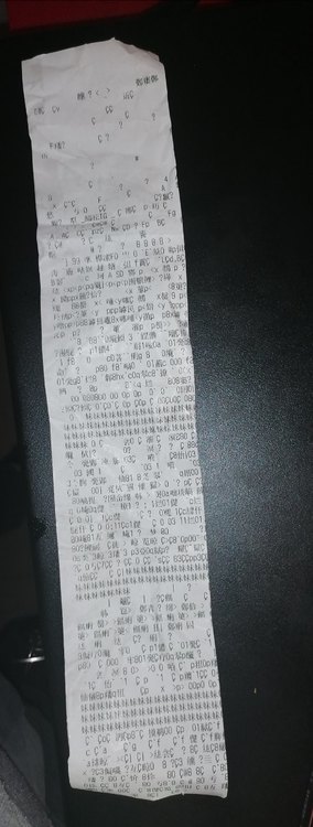

AlpBal Posted February 18, 2021 Posted February 18, 2021 Hi, Before i have used 2 unsupported Pos printers from Aliexpress. And They worked quite well. One of them didin't have Bluetooth other was without cashdrawer open option. So i have purchased a xprinter xp-58iih with both options available above . But it is randomly printing Long receipts from Chinese Symbols. Sometimes working many hours normal than printing symbols on next receipt..... CashDrawer also randomly working or not. Looks like Bluetooth going in sleep mode or something else i don't know but may be someone has same problem and solved? Thanks
Asu Posted September 2, 2021 Posted September 2, 2021 Hello i recently bought NETUM NT-1809DD bluetooth thermal printer from aliexpress. It works but sometimes like 1 in 10 times it writes weird characters like in the picture below.I tried different settings and configuration it didnt worked in "other model" selection of loyverse printer settings.i tried Selecting model as epson tm-m30 it wrote but this time i think epson paper width is larger than 58mm so end of the letter and total price wasnt visable and no setting to adjust in loyverse on epson model.Are there any solution for this in the loyverse or we are only allowed to use loyverse recommended printers.
John_Rocker Posted September 4, 2021 Posted September 4, 2021 Based on the problem you described, the cause may be in one of 2 cases. First, the printer has a small buffer, and therefore when graphics are being printed, the buffer does not have time to process it and starts to choke. The second possible reason is that the printer may not support the esk / pse command flash buffer, which flushes the printer buffer before receiving a new piece of information. Considering that your printer is bluetooth-enabled, which means that it has a slow exchange rate, I would recommend that you use text mode instead of graphic mode.

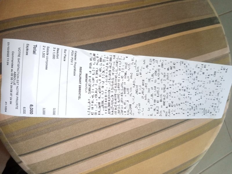

Bala Posted October 1, 2022 Posted October 1, 2022 Hello here. I have got issues with my printer.. Sometimes I got a long receipt with unknown message.. Thanks for your help.
Andy Posted October 5, 2022 Posted October 5, 2022 Hello. You may change to the Text mode from Graphic in the Advanced settings of your printer.

Georg Posted December 19, 2022 Posted December 19, 2022 On 12/17/2022 at 3:10 PM, kurtz322 said: Every time I print a receipt like 5 or 4 times this random print pops out randomly any idea how to fix this. You can try to change the print mode that you have selected in the Printer’s settings. For this, you need to go to the POS app->Settings->Printers-> Click on the name of your printer ->Go to Advanced settings and change the Print mode. Save the changes and try to print a receipt again. --- If this doesn’t help, it means that unfortunately, the printer you are making use of is not compatible with Loyverse POS app. If this is the case, we strongly suggest you to use a printer from the list of supported printers. The printers in this list have been tested and we can guarantee that they will work properly with Loyverse POS app.

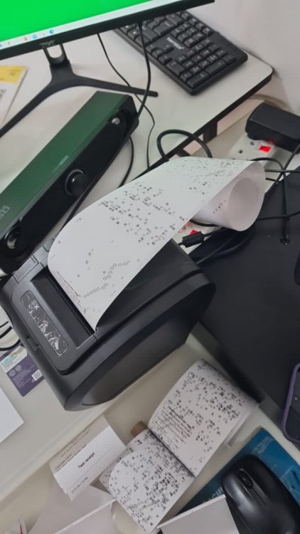

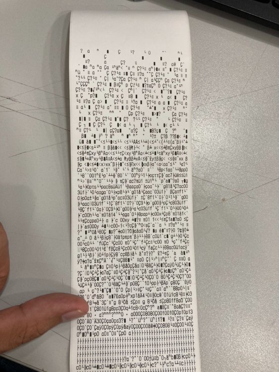

Mel Posted February 26, 2024 Posted February 26, 2024 (edited) Hello there, anyone else here faced the same problem where the POS printed out long, weird symbols when close shift? Helpppp It's a usb printer. Edited February 26, 2024 by Mel
Yasuaki Posted February 26, 2024 Posted February 26, 2024 Hello. Could you please send a photo of such a shift report?

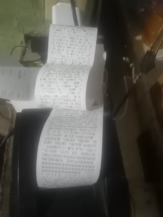

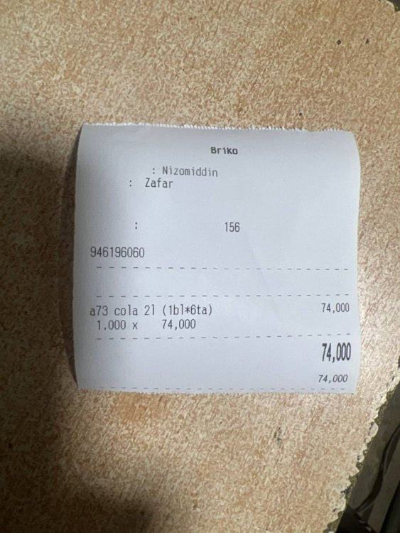

Brico Posted March 16, 2024 Posted March 16, 2024 (edited) Hello @Yasuaki and @Georg, I'm faced with the same dilemma and more. My bluetooth xprinter https://www.xprintertech.com/receipt-printer-xp-p810 was working ok before but after the last loyverse pos app update, Advanced Settings > Print Mode > Text: some details such as customer name, phone number, shop info are not visible. Advanced Settings > Print Mode > Graphic: receipts began to come out with weird symbols. It's doesn't happen every time. The first few receipts are ok but the following receipts are getting messed up. Currently, I'm using Samsung Galaxy Tab A7 (https://www.gsmarena.com/samsung_galaxy_tab_a7_lite-10933.php) but I tried test printing on and some other Android Phones and iPhone 15 Pro but the same issues occurred after a few successful attempts. Edited March 16, 2024 by Brico
Georg Posted March 17, 2024 Posted March 17, 2024 On 3/16/2024 at 7:02 AM, Brico said: My bluetooth xprinter https://www.xprintertech.com/receipt-printer-xp-p810 was working ok before but after the last loyverse pos app update, Advanced Settings > Print Mode > Text: some details such as customer name, phone number, shop info are not visible. Please, report it here:https://loyverse.town/forum/22-general-technical-issues/

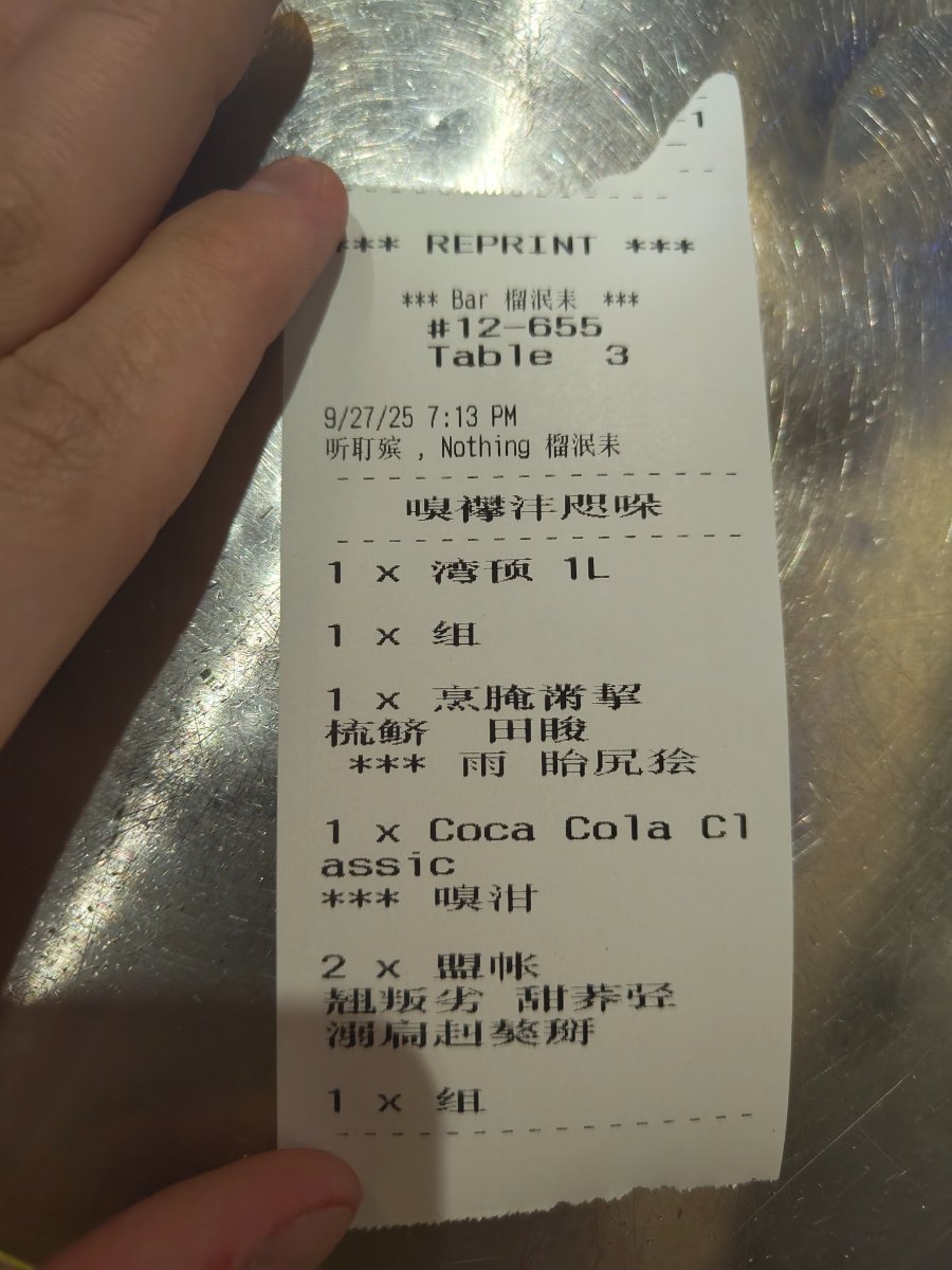

ZannikosA Posted September 27, 2025 Posted September 27, 2025 (edited) I have this problem I use the greek language on the text mode and I see this maybe Chinese language what can I do?... my language is greek Edited September 27, 2025 by ZannikosA
Georg Posted September 29, 2025 Posted September 29, 2025 On 9/27/2025 at 7:18 PM, ZannikosA said: I use the greek language on the text mode and I see this maybe Chinese language what can I do?. Hello Yes, it may happen if the printer is old or does not support the Greek codes. If so, you can print in Greek only with the Graphic print mode.
