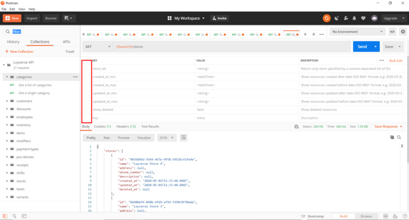

outtolunc Posted July 11, 2020 Posted July 11, 2020 I too seem to be having issues, my account doesn't have the 'get token' in the menu, so i am using the test one from first post in this thread. i have downloaded the loyverse postman, set the bearer token, and the baseUrl variable.. but every time it comes back with an error. i would also like the create token enabled on my account(s). { "errors": [ { "code": "INVALID_VALUE", "details": "The value must be an UUID", "field": "store_ids" } ] }
Yasu Posted July 12, 2020 Author Posted July 12, 2020 Hello outtlounc, Could you send a screenshot of postman? Probably you need to turn off all Key.

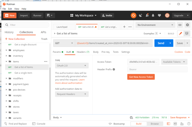

Sqquid Posted August 26, 2020 Posted August 26, 2020 Dear @Isobe_Yasuaki, I was trying to read items from the API but everytime I get a 403 error. Here you can see th Oauth config in postman and also, said token has items read pemission, so im not sure why am I getting this. Can you please help me?

Yasu Posted August 31, 2020 Author Posted August 31, 2020 On 8/26/2020 at 5:48 PM, Sqquid said: Dear @Isobe_Yasuaki, I was trying to read items from the API but everytime I get a 403 error. Here you can see th Oauth config in postman and also, said token has items read pemission, so im not sure why am I getting this. Can you please help me? Hello @Sqquid, Thank you for question. We need more information about your request. Could you tell me 1.If your token is valid? 2.What request did you send?
