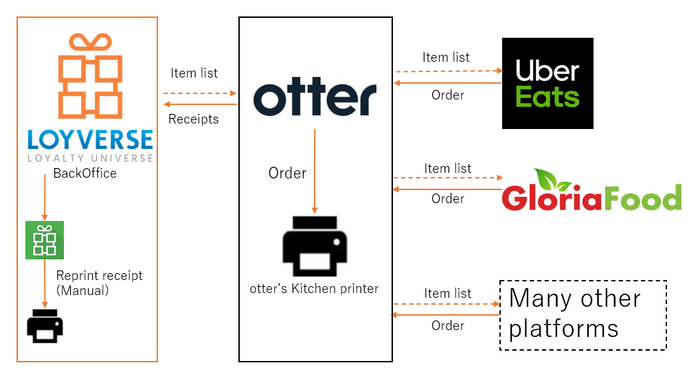

Hi Loyverse team, I want to bring back the request for creating orders via API. Right now, many restaurants use delivery apps like Wolt, Uber Eats, etc. Without this API, orders have to be entered manually into Loyverse, which slows things down and leads to mistakes. Receipt integration doesn’t really solve it because it bypasses key POS features like KDS and proper order flow. An order creation API would make it possible to: Integrate delivery platforms properly Use Loyverse POS + KDS as the main workflow Reduce manual work and errors in the kitchen If there are blockers, it might also be a reason some businesses consider switching to other POS systems that already support this. Is this something that could be reconsidered or added to the roadmap? Thanks!

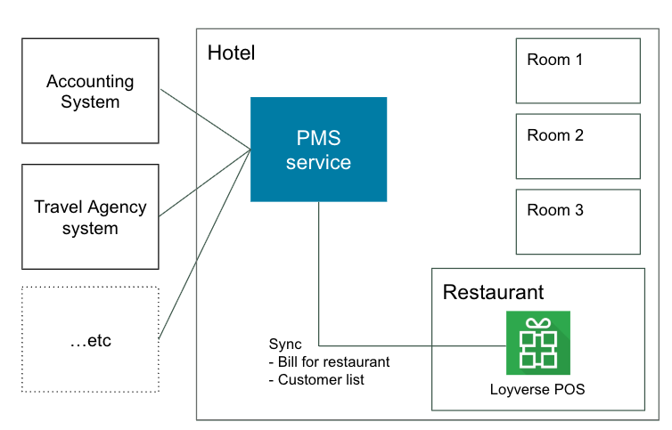

Benefits of Property Management Systems (PMS) and POS Integration in Hospitality
Yasuaki posted a topic in Loyverse API's Loyverse API
What is PMS? Who is the user? What are the benefits? A Property Management System (PMS) serves as the central operational hub—often called the "nervous system"—of any hospitality business. It’s a comprehensive software platform thoughtfully designed to help manage the day-to-day operations of a hotel, resort, or short-term rental property with ease. Who benefits from using it? A PMS supports virtually every department within a hotel, helping ensure smooth and coordinated operations: Front Desk Agents: They rely on the PMS for checking guests in and out, managing room keys, and handling guest profiles efficiently. General Managers: Use it to keep an eye on daily performance, occupancy rates, and overall revenue, helping them make informed decisions. Housekeeping Staff: Benefit from real-time tracking of room status (clean, dirty, out of order) and can manage daily cleaning schedules more effectively. Revenue Managers: Analyze booking trends, adjust room rates dynamically, and distribute inventory across online travel agencies (OTAs) to optimize revenue. How does it help your hotel? The main advantage of a PMS is automating many administrative tasks, which helps reduce human error and frees your staff to focus more on creating a wonderful guest experience. It centralizes billing, improves internal communication, and keeps booking data secure. The Development Relief: While a PMS excels at managing room inventory, hotels also need a Point of Sale (POS) system to handle their additional facilities like restaurants, bars, gyms, and gift shops. Historically, PMS providers tried to build their own POS modules to offer an "all-in-one" solution. However, creating a competitive POS requires ongoing, complex development to manage features like F&B inventory, table management, kitchen ticketing, and retail barcoding. By choosing a PMS-Freemium POS integration approach, PMS providers can relieve themselves of this heavy development load. Instead of stretching resources to build and maintain a secondary product, they can integrate seamlessly with a specialized, freemium POS through open APIs. This thoughtful strategy lets the PMS provider focus fully on their core lodging software while still offering hotels an easy way to route restaurant and shop charges directly to a guest's room folio. Statistics of value-added facilities (restaurants, gyms, shops) by hotel grade As a hotel moves up in star rating, it's completely understandable that managing value-added facilities becomes more important, and having a strong POS system to support this is essential. Here's a clear breakdown to help you see how facilities typically grow from lower to higher-grade accommodations: 1. Economy & Budget (1 to 2-Star Hotels) At this more modest end of the scale, the main focus is understandably on room revenue. Value-added facilities tend to be very limited or highly automated, which keeps things straightforward. Dining & Retail: Usually limited to vending machines or simple self-serve, complimentary breakfast bars. It's common for 1-star and 2-star properties to not have on-site, full-service dining options (RoomMaster, 2024). POS Needs: These are minimal here. Since charges are almost entirely for the room, the core PMS manages all billing smoothly without requiring a complex F&B POS system. 2. Midscale & Upper-Midscale (3-Star Hotels) This tier thoughtfully combines comfort with practical facilities, designed to meet the needs of both leisure and business travelers who appreciate having essential conveniences readily available during their stay. Dining & Fitness: We understand that many business travelers value convenience—according to a survey of those staying in midscale to upscale hotels, 47% prioritize having an on-site restaurant, cafe, or bar, and 27% appreciate access to a gym (BCD Travel, 2023). These amenities can significantly enhance your comfort and well-being while you're away from home. POS Needs: These hotels typically offer features like a casual dining restaurant, a small lobby bar, or a gift shop. An integrated freemium POS system can be especially helpful here, allowing you to enjoy these additional services smoothly without increasing the hotel's software expenses. 3. Upscale & Luxury (4 to 5-Star Hotels) For luxury properties, value-added facilities are more than just amenities; they play a vital role in enhancing your experience and significantly contribute to revenue. These properties offer multiple fine-dining restaurants, full-service luxury spas, expansive gyms, and high-end retail boutiques designed to delight and pamper you. The F&B Impact: Research by real estate and investment firm JLL shows that 60% of luxury travelers prioritize staying at hotels with excellent restaurants. These prestigious restaurants not only enhance your stay but also help high-end hotels achieve a 6.7 percentage-point higher occupancy rate compared to similar hotels without them (JLL, 2024). Revenue Contribution: It's important to note that food and beverage operations contribute a significant portion of profit—averaging 27.8% of gross hotel profit (JLL, 2024). POS Needs: For your convenience, a 5-star hotel relies on a highly advanced, multi-terminal POS system. This system expertly manages high-volume, complex orders across spas, poolside bars, and fine dining venues—all seamlessly syncing with your central PMS folio to ensure a smooth and personalized experience. Loyverse has several PMS integration partners Loyverse is one of the top freemium POS applications on iOS and Android, and it offers several PMS integration options to help you streamline your operations. Hotefy - Hotefy is a web-based PMS app that makes it easier for your guests to access hotel services through a convenient QR code. Cloudbeds - Cloudbeds is an all-in-one, cloud-based hospitality management platform designed to support independent hotels, hostels, vacation rentals, and B&Bs, helping you manage your property with ease. Room Charge - Room Charge acts as middleware connecting Loyverse with over 10 PMS services, including Cloudbeds and Opera, to simplify your integrations. The following image illustrates a general POS - PMS integration structure to give you a clearer understanding. By syncing a customer list and sales in a restaurant, hotels can comfortably benefit from the intuitive freemium POS, designed to make your work easier. Loyverse FREE features include helpful tools such as: KDS/kitchen printer to streamline your kitchen operations Variation of items to help you customize your menu with ease Ingredient management so you can keep track of your supplies effortlessly Dining option to accommodate your customers’ preferences …and more features designed to support your business smoothly. -

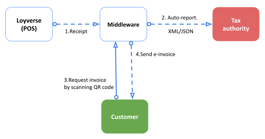

Hi is there some kind of documentation how to create an extension to integrate with electronic invoice for an specific country

Global e-invoicing is a huge, standardized ETL (Extract, Transform, Load) and API integration challenge. Viewing the 2024-2026 e-invoicing landscape as more than a tech upgrade reveals a major shift in business and government communication. From 2024 to 2026, e-invoicing shifts from a "nice-to-have" to a global mandate. The key driver is now fiscal transparency. Governments aim to close the "VAT Gap" by requiring real-time transaction reporting. 1. Trends in e-invoicing A. From post-audit to "clearance" models Traditionally, invoices were sent and reported weeks or months after transactions (post-audit). The main trend for 2024–2026 is shifting to Continuous Transaction Controls (CTC), requiring real or near real-time invoice data submission for continuous monitoring. Invoices are legally valid only after "clearance" via government platforms in real time, ensuring compliance before completion. This prevents "missing trader" fraud by giving tax authorities real-time visibility and matching data from buyers and suppliers for accuracy. B. The end of the "PDF" Standard PDFs sent by email no longer qualify as true "e-invoices" since they lack structured data needed for automation. The move away from PDFs supports more efficient, automated financial processes with less manual work. Trend: e-invoices now mean structured data in machine-readable formats like XML or JSON for automated processing. "Paperless" invoicing is outdated; the aim is "touchless" invoicing—fully automated from issue to payment without manual steps. C. Lowering of exemption thresholds E-invoicing mandates, once for large B2B firms, are expanding to include small and medium businesses (SMBs) by 2026. This broadens transparency and compliance across all business sizes. Revenue exemptions are lowered or removed, so even small merchants previously exempt must comply. D. Market growth The global e-invoicing market will grow as mandates spread across regions and industries. Growth is fueled by digital adoption, regulations, automation benefits, and fraud reduction. Market valued at about USD 15.9 billion in 2024, forecast to reach USD 68.7 billion by 2033, growing at a CAGR of 16.8% 2. What this means for SMB merchants For small merchants, this change may seem like a compliance task but brings key operational benefits. Here’s the selected table converted into HTML: Benefit Description Faster Cash Flow (DSO Reduction) Structured e-invoicing removes the "black hole" of emailed PDFs. Machine-readable invoice data allows instant approval by buyer's accounting software, reducing Days Sales Outstanding (DSO) so SMBs get paid faster. Cost Reduction Manual paper or PDF invoice processing costs more due to printing, postage, and errors. Automating saves money and time. Access to Supply Chain Finance Real-time invoice validation creates trusted data. Banks use this to offer faster, safer financing to SMBs, improving working capital. Future-Proofing As major buyers adopt standards, they’ll reject non-standard invoices. E-invoicing keeps SMBs "trade-ready." 3. How it works This section explains the technical setup behind modern e-invoicing. The "Structured Data" Standard Unlike PDFs, true e-invoices are text files in code formats like XML or JSON. UBL (Universal Business Language): A global standard. Semantic Mapping: Ensures "Total Amount" matches exactly between sender and receiver systems, regardless of software. The Four-Corner Model (Peppol Network) The common 2024-2026 framework, the Four-Corner Model, works like sending an SMS between different carriers. Corner 1 (Supplier): Sends invoice to their Access Point. Corner 2 (Sender’s Access Point): Converts data to a standard format and sends it securely. Corner 3 (Receiver’s Access Point): Receives, validates, and converts data for buyer's software. Corner 4 (Buyer): Gets clean data directly into their ERP or accounting system. This lets an SMB using "Software A" bill a client using "Software B" without custom links. API-First Connectivity Modern e-invoicing uses RESTful APIs for communication. Instead of manual entry on portals, accounting software uses APIs to send invoices directly to tax servers. Security: Encryption and digital signatures protect data during transit. 4. Real case Loyverse works with middleware like Myinvoice2u and Jomeinvoice to help SMBs meet Malaysian LHDN e-invoicing rules. They built the integration using the Loyverse API, providing a strong platform to connect services and support Malaysian merchants efficiently.
