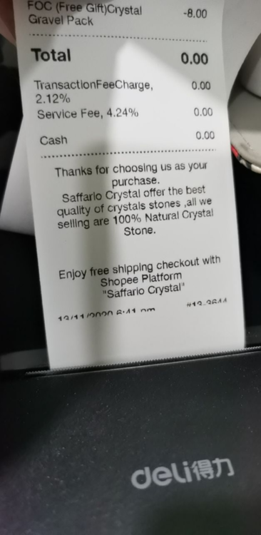

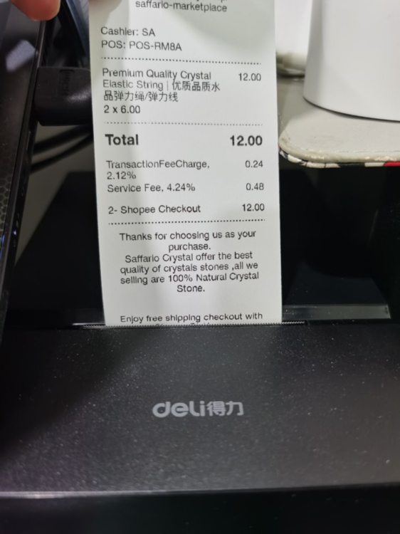

Hi, when I set the cutter commands, 0А,0А,0А,0А,1D,56,42,00 , it cut off one of the item on the receipt and the other half printed at the buttom. Please help. Thank you
Please, send a photo once again. I can't open the one you sent.
