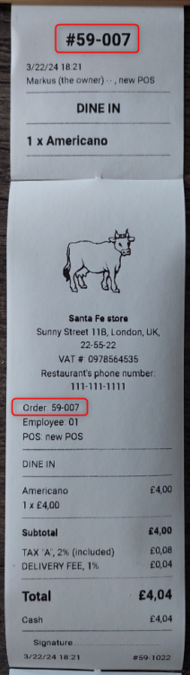

Georg Posted May 13, 2025 Posted May 13, 2025 On 5/8/2025 at 4:11 AM, ROCO said: We are testing our pos (no printed receipts nor customer display) just an android pos for order taking (cash only) and a iOS KDS. Orders come thru to kds with the pos number then sequential numbers. That’s fine. The issue is, the person taking the order can’t see the sequence receipt numbers as displayed on the kds. We are about to give up. Hello Please check this information. I hope it will help: The order number is displayed only on a paid printed receipt (if the open ticket was not saved), on the KDS, or on the printed kitchen order. The meaning of the numbers in the order: Example #59-007 59 - is the POS number; 007 - is the order number; When the order number reaches 999, it starts again from 001.
ROCO Posted May 13, 2025 Author Posted May 13, 2025 Thanks. We were trying to achieve without using a printer or customer display. Determined it couldn’t be done so we bought a little seiko receipt printer for this purpose only. 1
