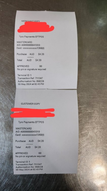

Recently, I purchased pos printer(Rongta RP326) and it works well.
However, there's a problem with tyro. Because the option is print receipt and bill, pos printer print receipt as well which is "Merchant copy" and "Customer copy".
I just want to print customer bill only which is TAX INVOICE we called.

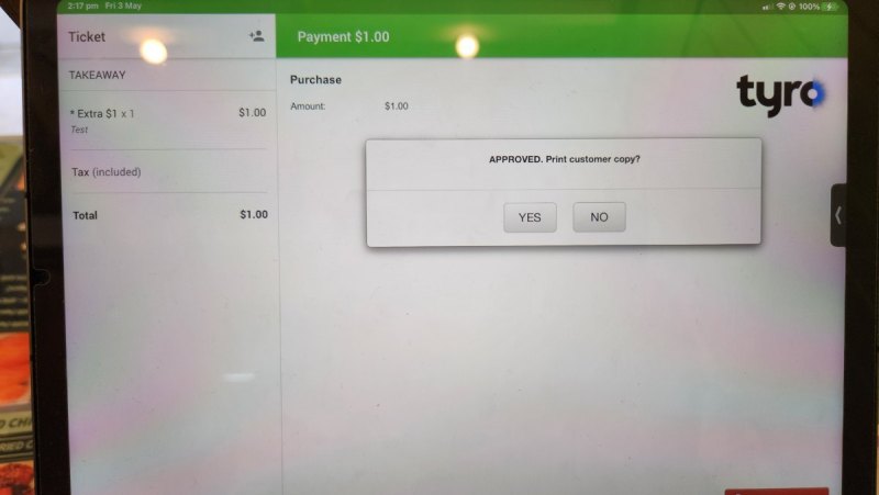

Problem : when I turned off this option, pos printer doesn't print out the receipt(Merchant and customer copy). Instead, after every sales, loyverse is showing this and I must have to press the button.
I don't want any copy.
Also, when I press, No, Tyro start to print Merchant copy by itself.
So I took our paper from Tyro. It's very annoying

1. I don't want the stupid question "print customer copy?"

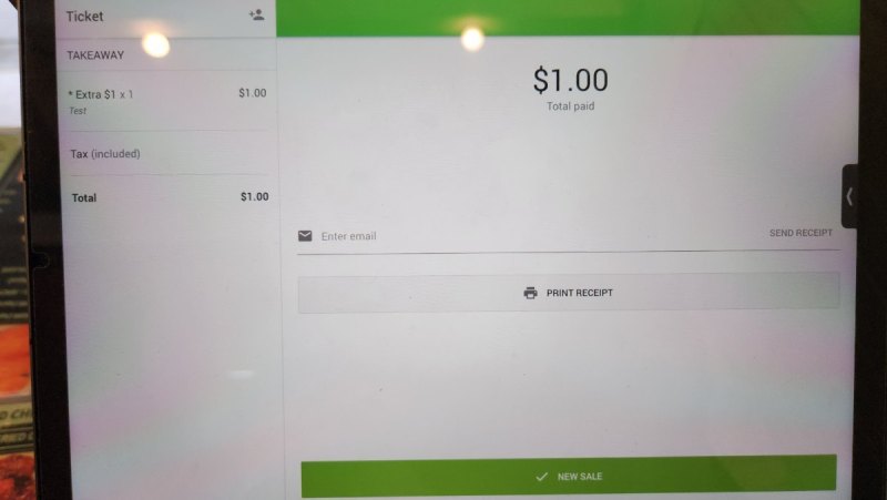

I replaced my Tyro countertop to Tyro Pro.
Now, loyverse doesn't show that stupid question anymore.

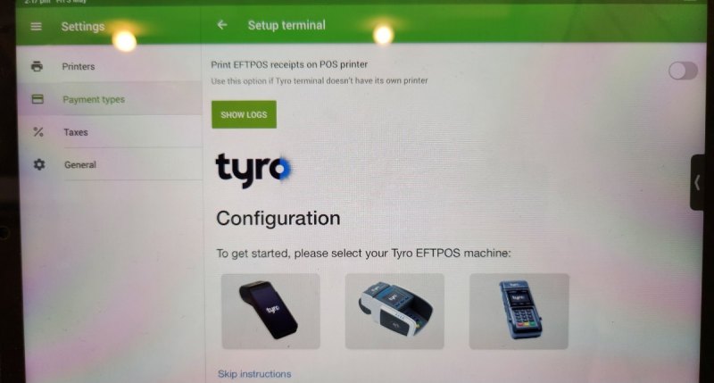

For someone may need, I'll share the option
From loyverse
Turn on print receipt and bill from your receipt printer
Turn off print EFTPOS receipts on pos printer
From Tyro
Change merchant receipt to Never
Turn off print and email from customer receipt
Now only Print receipt button shows at the end of every sales without any hassles
