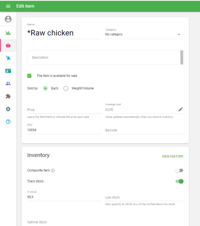

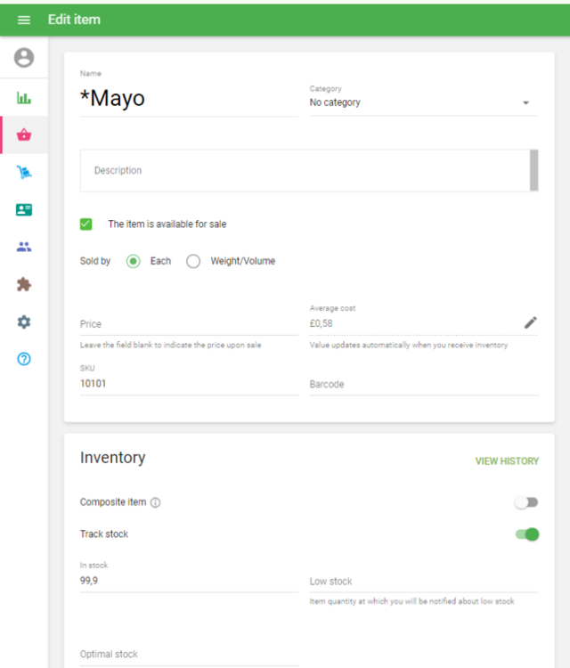

You should first create items "raw chicken" and "mayo", with track stock enabled.

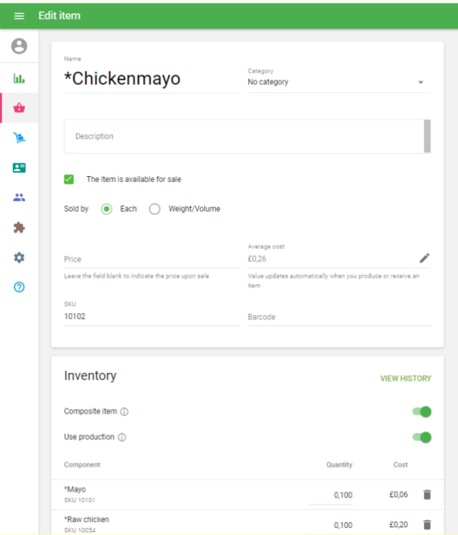

Then create a composite item "chicken mayo", which will contain "raw chicken" and "mayo" as components (with the quantity you use to produce "chicken mayo")

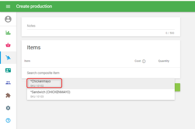

This item should have production enabled, which means you can make the "chicken mayo" in advance and have the components of this item decreased. By using the production, this item will get its own stock.

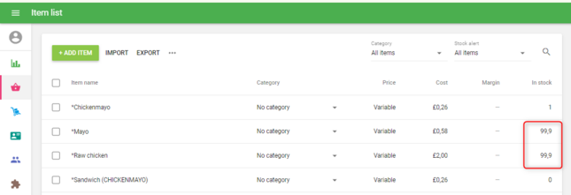

You can see that raw ingredients were deducted after making a production:
