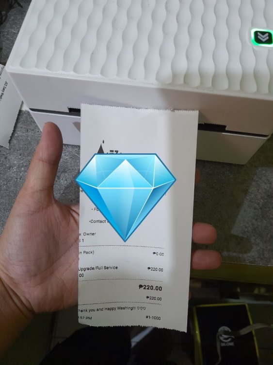

Hi, how to adjust the leftside margin of the printung receipt? I ttied printing receipts but its not full print in the leftside part.
Printer : GD41-BT (China Brand)
Paper: 80mmx 70mm
Note: I already tried changing the width in the advance setting still it did not work.
I also tried adding 0A,0A before the original figures in the Cutter ESC, still it did not work 😞
Please help and Thank you in advance!

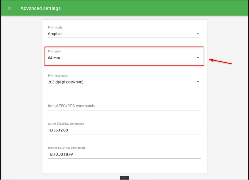

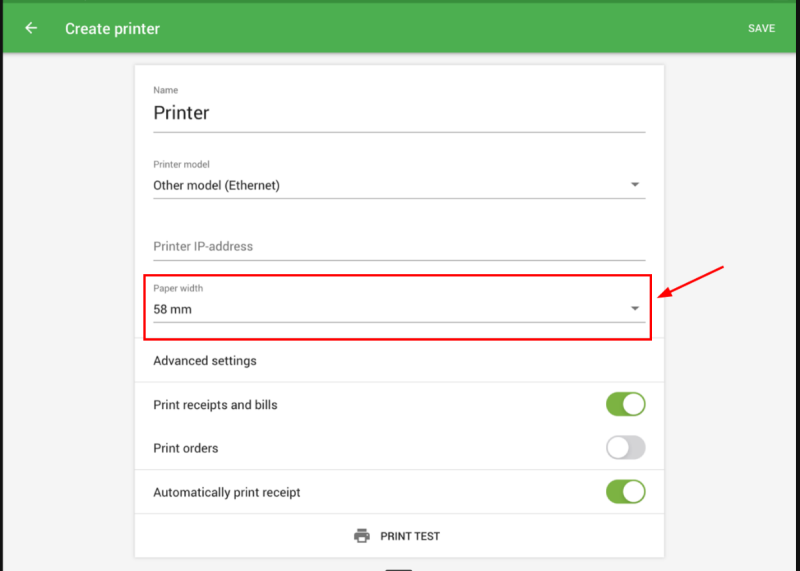

Did you try to change the PAPER WIDTH as well as the PRINT WIDTH?
Please make sure you tried both:
