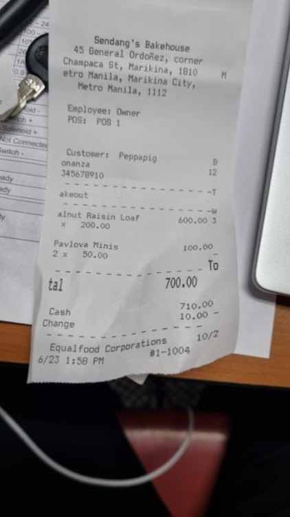

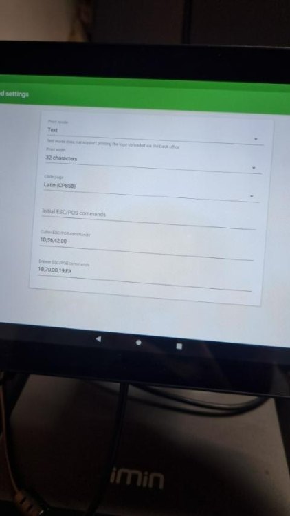

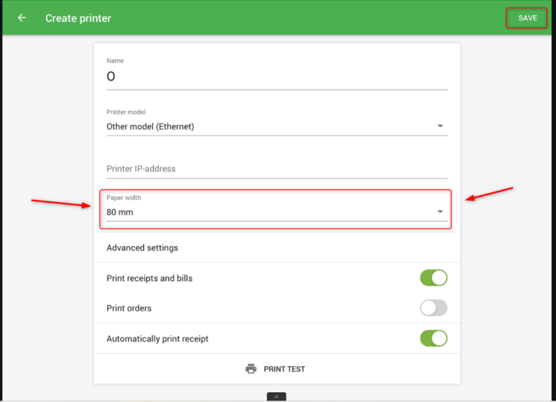

I am very new to POS system, Can someone help me to fix printing issues (Please see attached image) using Loyverse application. I am using Imin D2-402 and Epson U220 dot matrix. Thanks in advance guys!
Cheers!

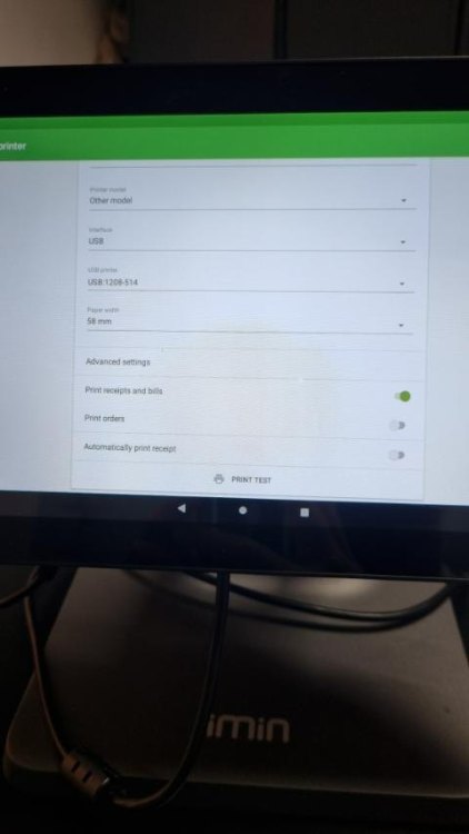

You can try to change the PAPER WIDTH first:

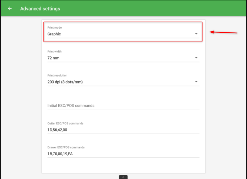

If it will not help, please try to change the PRINT MODE into GRAPHIC:

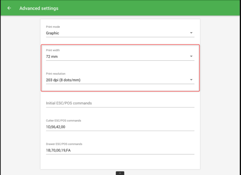

If it will not help, please try to change a PRINT WIDTH or even PRINT RESOLUTION:
  • 4 months later...
I wonder was any solution found for this issue . I am experiencing the same
Did you try the solution I sent above?
I tried lots of settings, when I choose graphic I am only getting lots of mixed text like Chinese.

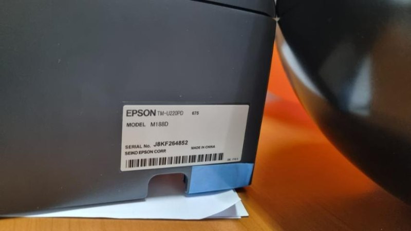

Hi there! Unfortunately, there is no solution for this one, this is a compatibility issue with my Epson printer and Loyverse. if you want to use Loyverse it is recommended to use the listed printers on Loyverse or Thermal Printers.
