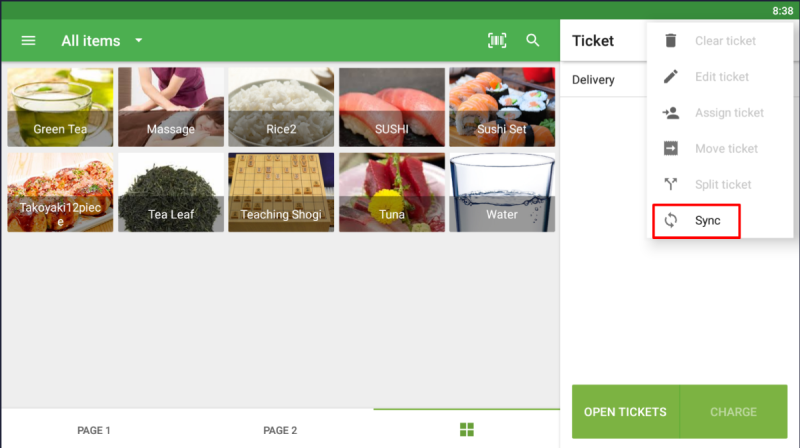

Please make sure that your POS device is connected to the Internet and then press the Sync button.
You can also try signing out of the POS device by carefully following the steps in the tutorial below and then logging in again.
How to Sign out from Loyverse POS

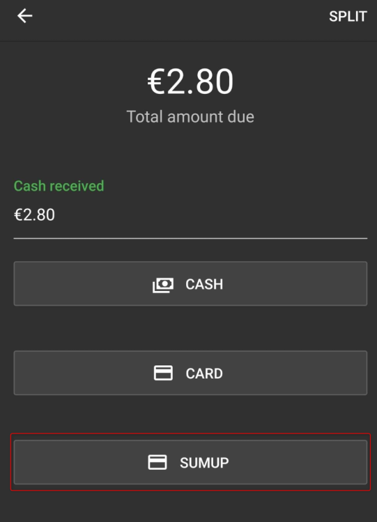

Please also keep in mind that connecting Sumup on Android is done differently than on iOS.
To connect the SumUp card reader to Android devices, you have to make a test sale and select the Sumup payment type.
You will see an invitation to download the Sumup app. Tap the ‘Download app’ button.
You will be redirected to Google Play to the SumUp app. Install the app to your device and launch it.
Note: For using the SumUp App on Android devices, the required operating system is Android 6.0 or higher.
You will see the welcoming screen of SumUp app. Tap the ‘Get Started’ button.
Enter Email and Password from your SumUp account.
You will see an invitation to make payment through SumUp app.
Now you can close this app and go to accept payments through Loyverse POS.
Note: SumUp works only with mobile devices with geolocation enabled.
