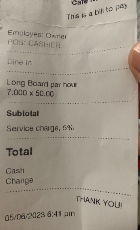

Print out Receipt doesnt come with total amount to be paid
How can I include the total amount in the print out? It shows in the tab but not in the print out.

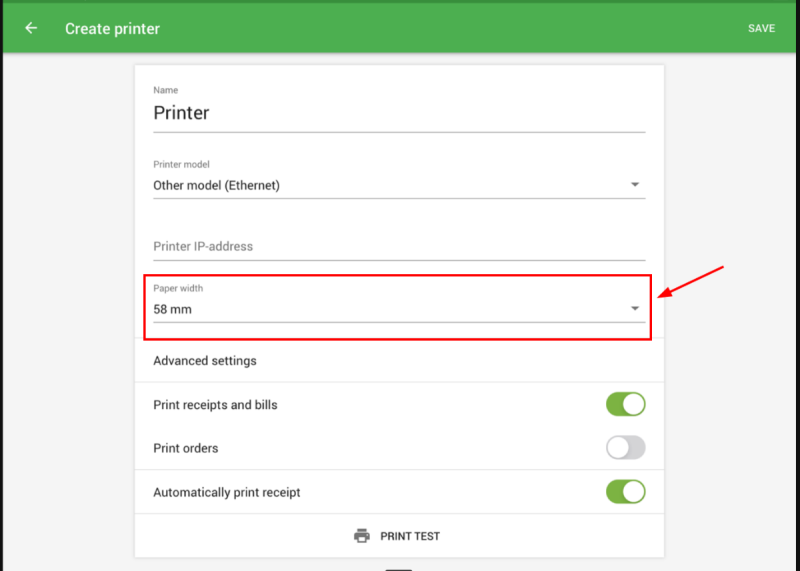

It happened because you are using not supported printer model with the Loyverse POS App.
You can try to choose the smallest paper width of the printer settings in the Loyverse POS App to fix this issue:
