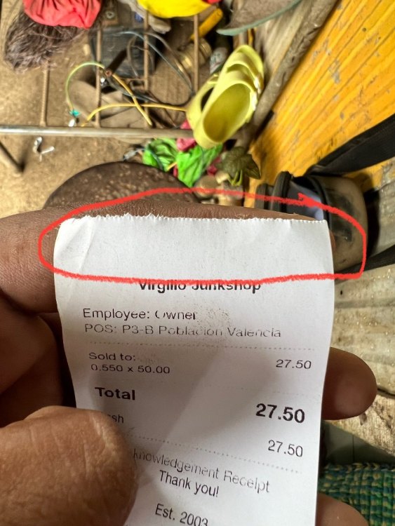

Hello. I just want to ask how to adjust receipt headers because their is too much space on the top
Could you please show a photo of the printed receipt to see how it looks now?
This space. It saves paper on the long run

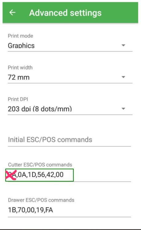

We do not have special settings for this purpose, but you can try this way:
Please go to the App → Settings → choose your printer, then open Advanced Settings → and in the field 'Cutter ESC/POS Commands' remove one "0A" before existing values. Maybe it will help.
Example:
You will receive   0А,1D,56,42,00
