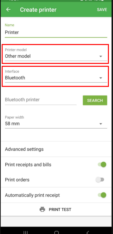

Please, note:
We do not have the integration with the device shown on your picture and can't guarantee its proper work with the Loyverse POS App, but you can try to activate built-in printer as OTHER MODEL Bluetooth printer:
If you already connected it the same way and it still prints strange symbols on the receipt, please open printer settings in the POS App, click on the "Advanced settings" and change a PRINT MODE. It might help.
