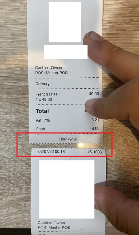

Receipt's date and receipt number margin problem(it is printed on the next receipt)
Hello everyone, i have this problem on my printed receipts as you can see on following images
any idea about how i can fix this?
my printer is Sunmi NT212 cloud Printer 58mm
Thank you!
We do not have integration with this printer model, but you can try to fix this issue using this short tutorial:
Please go to the App → Settings → choose your printer, then open Advanced Settings → and in the field 'Cutter ESC/POS Commands', add 0A,0A before existing values. (This will make printer feed more paper at the end of receipt.)
For example:
You would have to write 0А,0А,1D,56,42,00
