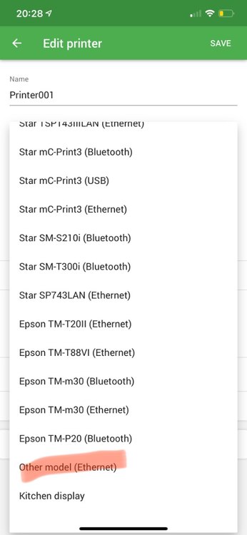

So i just bought my Xprinter XP-58IIH recently. Although i read some topics here that Loyvese is not supporting this printer however this works perfectly with some of the videos that i watched.

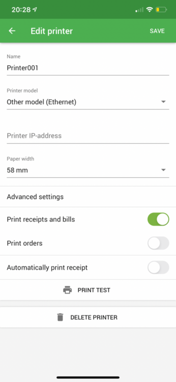

Whenever I am choosing Other Model in the Printer model option it always includes (Ethernet) and i don't have any other option to choose like USB or Bluetooth. I am using iPhone 11 Pro Max with iOS 14.2.

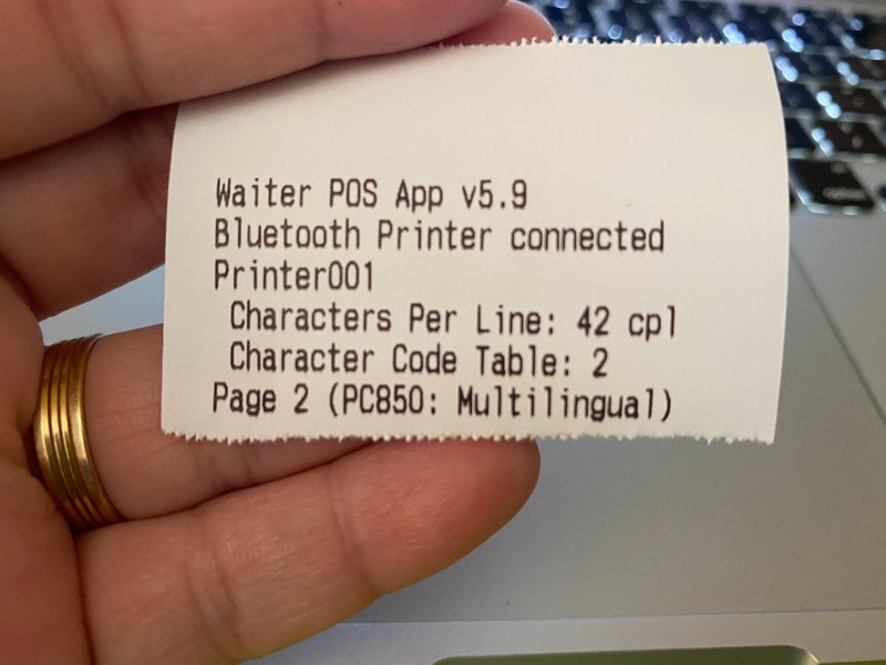

*Note: I tried using the same iphone and xprinter with Xlabel the bluetooth device is connecting and is working properly. I hope this issue with ios user will be fix soon.
Hope you could help me in this problem. I attached some photos for your reference as well.

Hello.
It is possible to add an other model of the printer to iOS only in case of models with Ethernet devices.
This situation is based on iOS requirements of connecting USB and Bluetooth devices.

This is an answer I saw before on the forum and explains it pretty well.
"For Bluetooth and USB interfaces, only models from recommended printers list with work with Loyverse POS on iOS.
For iOS devices, it is possible to try as other models only Ethernet printers, which fulfill requirements of supporting ESC/POS protocol.
Why?
Because only MFi certified devices are possible to connect with iOS devices via Bluetooth and USB interfaces.
Apple’s MFi Program (“Made for iPhone/iPod/iPad”) is a licensing program for developers of hardware and software peripherals that work with Apple’s iPod, iPad, iPad mini, and iPhone.
But even for MFi certified receipt printers, our Loyverse development team needs to have them and to integrate their work with Loyverse."
