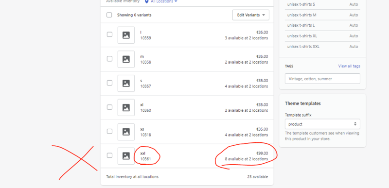

ilih Posted November 18, 2020 Author Posted November 18, 2020 now i end up with shopify products that have a variant of a different product like this one:
ilih Posted November 18, 2020 Author Posted November 18, 2020 above product, in the image, doesnt have an xxl option and it doesnt cost 99 euro. This product did have an xxl option long time ago but it was deleted in shopify long time ago. now shopify sees the same sku again and thinks it belongs to that product as a variant. but it should be a variant of another product.
Alex Posted November 18, 2020 Posted November 18, 2020 Hello, If variant is deleted in Loyverse you can delete it in Shopify as well (deleted variant will have some value for "deleted_at" attribute). Main point that Loyverse does not allow to have 2 existing (not deleted) variants with same SKU and this is also how most of ecommerce platforms work.
