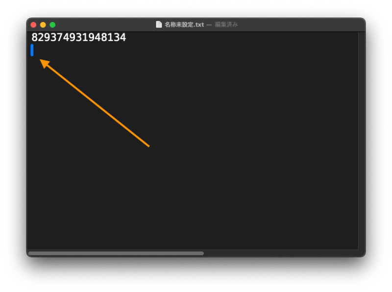

Yasu Posted September 6, 2024 Posted September 6, 2024 On 11/2/2022 at 3:13 PM, DNDJ said: Same problem over here with a Netum NT-1228BC Bluetooth scanner. The scanner is not working during sale, but working on encoding barcode and searching. Carriage return or CR function is switched on. Any idea? On 7/8/2024 at 2:45 PM, JJMART said: Hello, I have the same problem here. It worked for a while, like a few days, then all of a sudden it stopped working and we have to go through the search function for each article which is not efficient. Like others, I have tried to reconfigure the scanner to add a CR or any other options but it doesn't help. Please assist. On 7/8/2024 at 2:52 PM, JJMART said: I will add that I have 2 different barcode scanners, one iOS tablet and one Android tablet and the problem is the same. I have also tried with USB or Bluetooth scanner, no difference. Hello! Could you open any text editor app and read a barcode on it? The cursor should go to the next line if CR is activated on the barcode reader. If not, probably, the CR is not activated on your barcode reader.

ECS Posted October 18, 2024 Posted October 18, 2024 On 9/6/2024 at 9:35 AM, Yasuaki said: Hello! Could you open any text editor app and read a barcode on it? The cursor should go to the next line if CR is activated on the barcode reader. If not, probably, the CR is not activated on your barcode reader. Thanks for the answer, i checked the CR activation as you mentioned before and it pass an ENTER at the end but still though not working on some devices as Ipad Air 2 but i managed to make it work on my Mi10T phone, i was thinking fir that the problem is from my barcode scanner but it seems there is some bug on the main page of Loyverse. I hope you fix that as soon as possible
Yasu Posted October 28, 2024 Posted October 28, 2024 On 10/18/2024 at 2:54 PM, ECS said: Thanks for the answer, i checked the CR activation as you mentioned before and it pass an ENTER at the end but still though not working on some devices as Ipad Air 2 but i managed to make it work on my Mi10T phone, i was thinking fir that the problem is from my barcode scanner but it seems there is some bug on the main page of Loyverse. I hope you fix that as soon as possible Hello. Just for your information, we support only Socket Mobile scanners for Loyverse POS on iOS. If you are using Socket Mobile, please make sure that the Socket Mobile scanner is in "Application mode".
