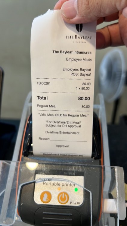

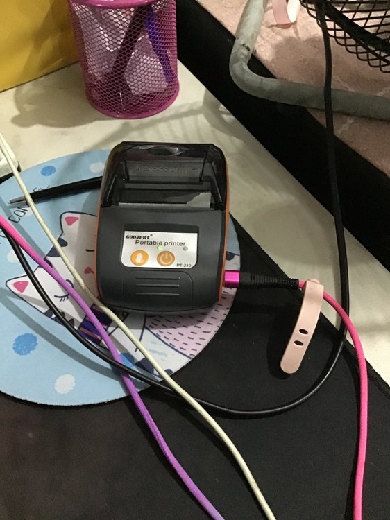

I made with my China printer Goojprt PT-210 in the field 'Cutter ESC/POS Commands', add 1B,64 before existing values.
Edited by 106B
  • Fire 1
Best option  after 'Cutter ESC/POS Commands'  1B,64,0A,1B,64,0A

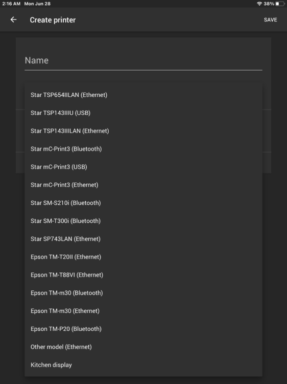

Hello can someone help me , on my ipad i cant connect on my printer its showing on other model is ethernet , and i dont know the IP address of my printer but when i tried on my android it works on but on my ipad it not working its not showing the Bluetooth  ty for your help878A90C7-4471-4CE6-809D-8C53FA8BAC83.thumb.png.161ac7d8cae117bd3a8a7a367ded4839.png18FF7EF3-0F0B-4DCB-8E6F-259F41FFF3EE.thumb.jpeg.33647d536726e3871ad7d1266bb3599b.jpegimage.thumb.jpg.d4d23df823575d08bdc88774ab485c48.jpg
I was told that for iOS, I can only connect other printers using Ethernet/WiFi but for Bluetooth and USB only printers from the list will work.

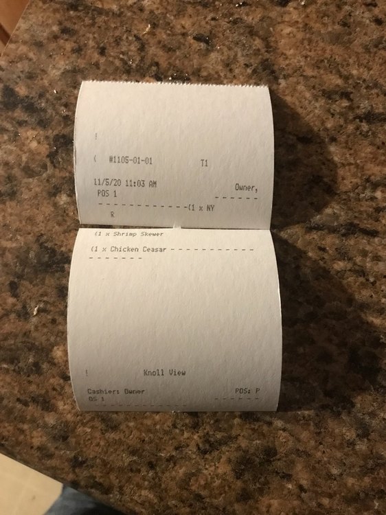

Same problem with me. Even though i used all the codes.
It will be ok but eventually it go back to the problem.

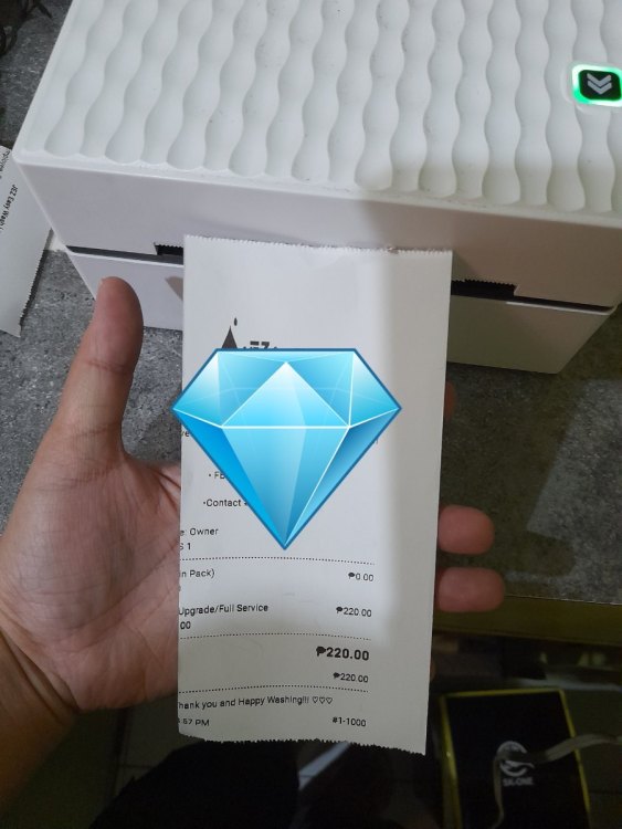

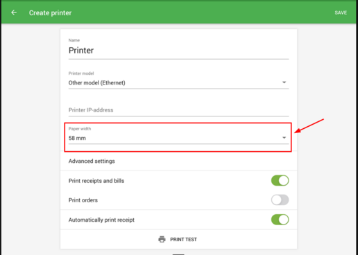

How can i align text to right side using commands ? I already test all width but the text always on the left side
@Macmac @balaibaibaiThis problem happens when you use 58mm width paper but your setting is 80mm.
Please, open printer settings in the Loyverse POS App and choose the smallest PAPER WIDTH there. Save settings and try to print a new receipt.image.png.b604fa823a2a20fc8898e8be96ef791e.png
