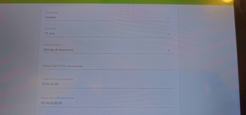

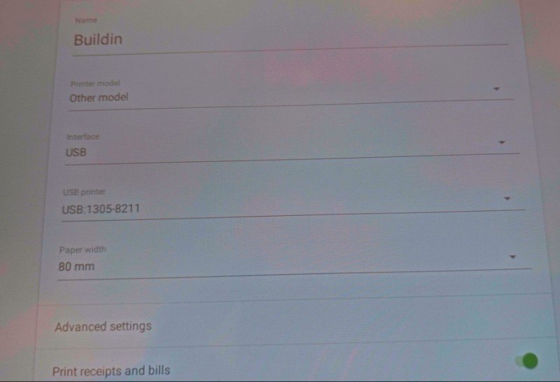

Our D4 will only print in usb mode, the draw will open from diagnostics on the tablet but not in Loyverse. Please help.
Hi, could you post the screenshot of your printer settings? (Including Advanced settings)

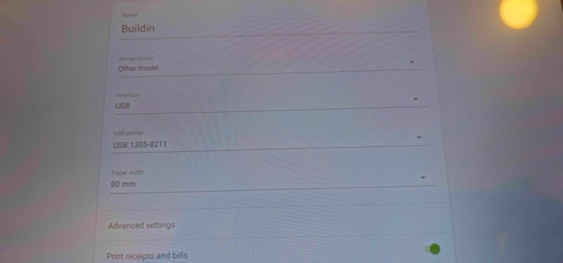

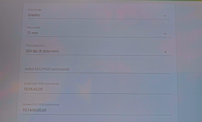

imin android pos system printer building USB Interface
Edited by KDACafe

On 12/3/2024 at 10:55 AM, KDACafe said:
On 12/3/2024 at 10:57 AM, KDACafe said:
Cash drawer not opening after printing
Hello. Thank you for your screenshots.
May I know if you are able to print receipt via USB interface?
