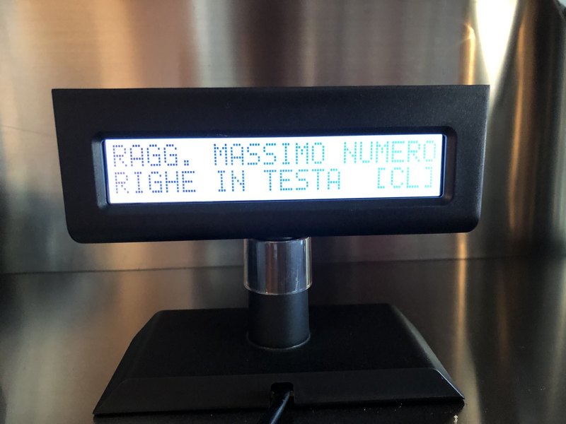

We joined the beta program for Fiscal Printer Support in Italy - I am using a RCH Print F!. Since a while on every transaction that goes through the Fiscal Printer I get the following errore code:
"RAGG. MASSIMO NUMERO RIGHE IN TESTA [CL] " - followed by 3 beeping sounds by the printer.
The transaction goes through and is registered, however I do not know where the problem comes from. Is anyone familiar with this issue?

RCH Print F! cannot print more than 6 lines in a header. Please check the number of lines in your header, try to increase it and print again.
