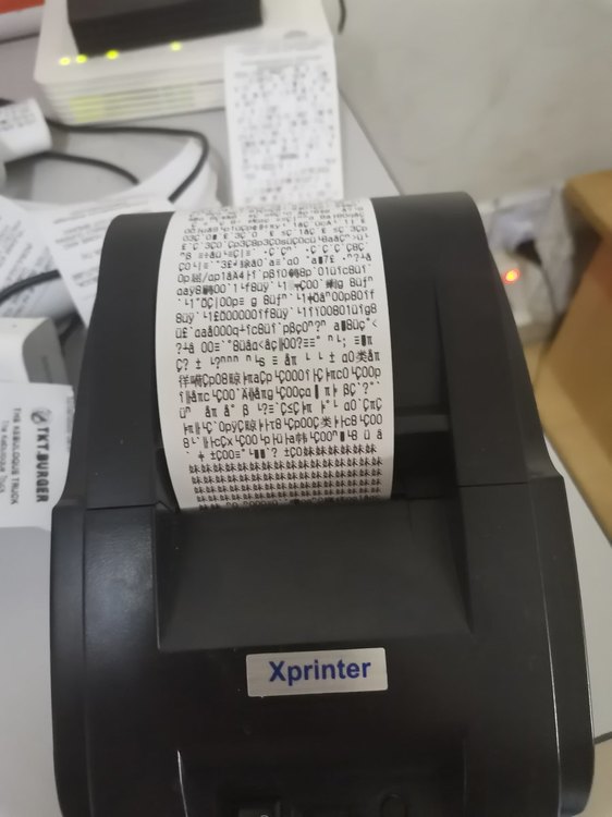

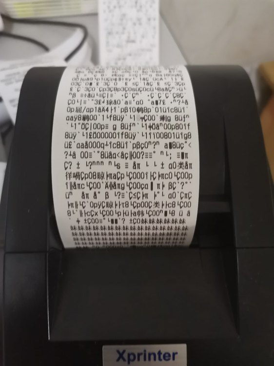

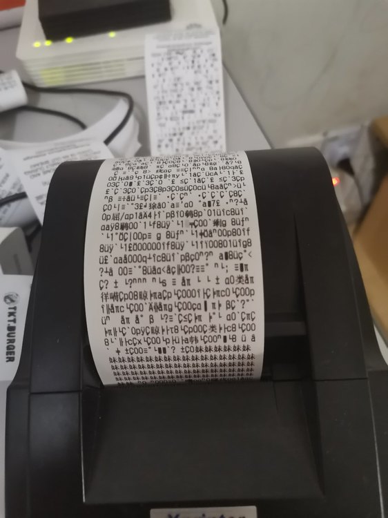

Sometimes when I was about to print the receipt, there were a slight lag that turned out to make the receipt printed out with Chinese words and it will not stop printing unless I switched off the printer, I've tried changing the printer but indeed it still happens. I really hope loyverse will consider to fix this because I would love to use it again as it is very user friendly and easy to use

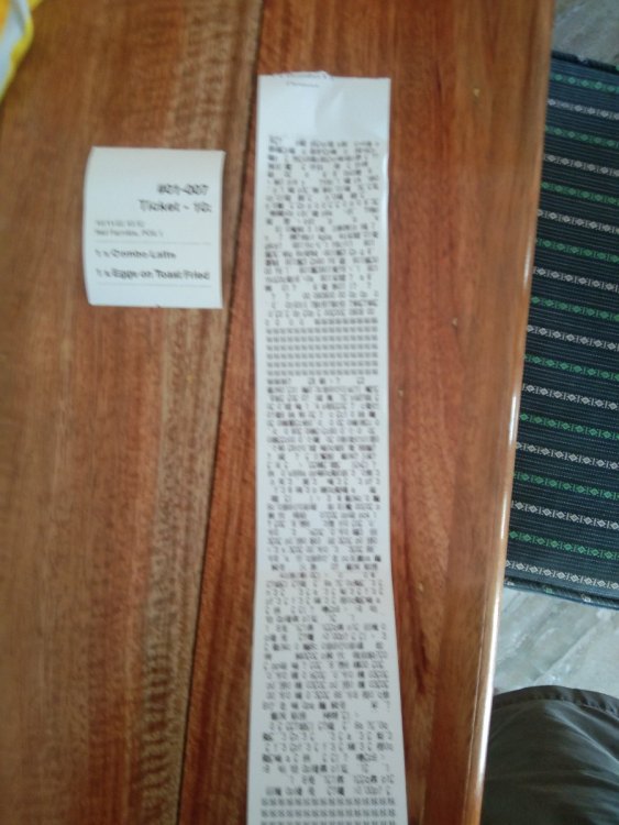

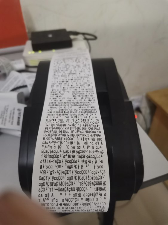

I have just bought an Xprinter and have set it up to print kitchen orders and customer receipts. It prints the kitchen receipt okay but then when I ask it to print the customer receipt it goes crazy and prints a long stream of Chinese characters. Please help....
