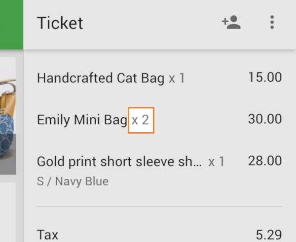

Solution Andy Posted June 5, 2020 Solution Posted June 5, 2020 Hello. The best way to do this is to use separate barcode scanners. The separate devices have a button when you push it; it scans the barcode. It is simple to push this button several times to increase the quantity of the item on the ticket. Please, check the list of supported barcode scanners. https://loyverse.com/hardware https://help.loyverse.com/help/supported-barcode-scanners

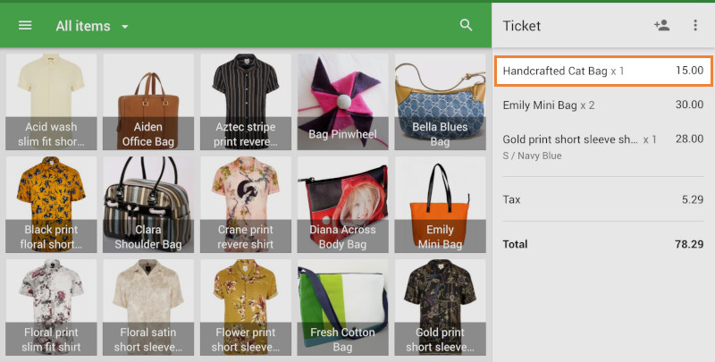

Mia Posted June 5, 2020 Posted June 5, 2020 Hello, Do you use a barcode scanner to add items to the ticket? When you scan your item’s barcode with a scanner, this item will appear in your ticket. If you scan the same barcode one more time, the number of items will increase by one. You can also use the built-in camera of the POS device as a barcode scanner. You can read how this works here: https://help.loyverse.com/help/barcodes-scanning-built-device How do you search for your items?
