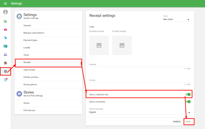

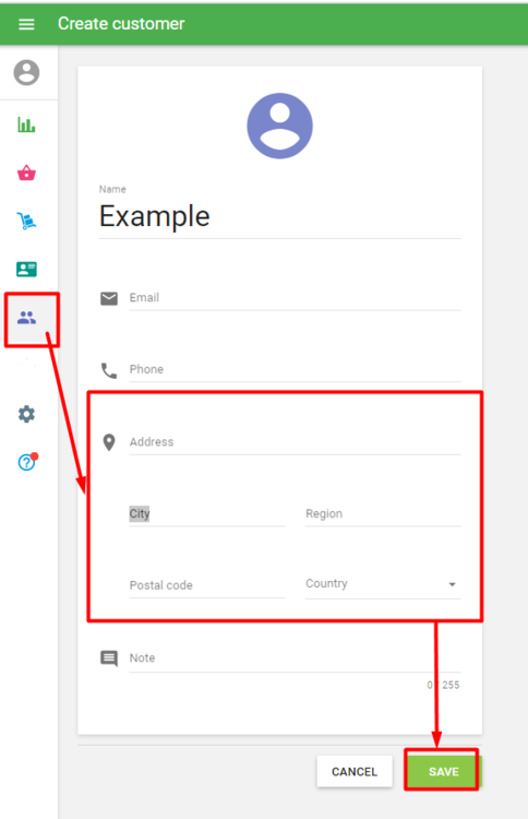

Solution Mia Posted May 15, 2020 Solution Posted May 15, 2020 Hello, You can add the address of your customer in the customer profile: To print the address on the receipt you need to activate the option "Show customer info" in your Back-office->Settings->Receipt settings. You can read more details here: https://help.loyverse.com/help/customer-info-receipt 1

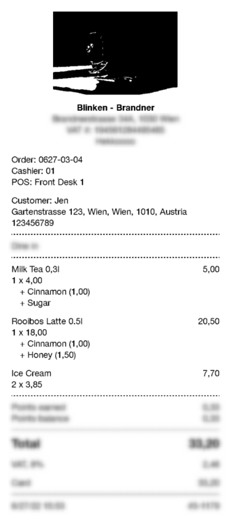

Blinken Posted June 27, 2022 Posted June 27, 2022 I created a fake customer to add to a ticket to try and when I fill out address of the customer in their profile, it does show up the address on the receipt but I don't see the email, maybe it got updated. I had to enable "Customer info" in Back Office, receipts settings.

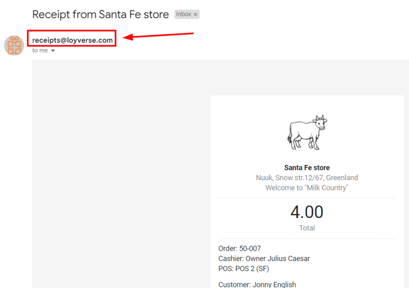

RetailSolutions Posted January 19, 2023 Posted January 19, 2023 Is it possible to change the sent from email address on the digital receipt?
Georg Posted January 20, 2023 Posted January 20, 2023 22 hours ago, RetailSolutions said: Is it possible to change the sent from email address on the digital receipt? Do you mean, you would like to change the sender email address?
RetailSolutions Posted January 22, 2023 Posted January 22, 2023 Hi Georg, yes, the company it's coming from.
Georg Posted January 23, 2023 Posted January 23, 2023 On 1/20/2023 at 12:00 AM, RetailSolutions said: Is it possible to change the sent from email address on the digital receipt? Hi Do you mean, you would like to change SENDER email address?
RetailSolutions Posted January 23, 2023 Posted January 23, 2023 Yes, this is correct. How can it be changed to another email?
Georg Posted January 23, 2023 Posted January 23, 2023 1 hour ago, RetailSolutions said: Yes, this is correct. How can it be changed to another email? It is not possible to change SENDER email address directly in the Loyverse POS settings, but you can contact our CONNECTORS partners from Loyverse MARKETPLACE and ask them if they can help you to let your customers receive receipts from your email address instead of Loyverse email address:https://loyverse.com/marketplace How to Connect Apps from the Marketplace to Loyversehttps://help.loyverse.com/help/connect-apps-from-marketplace
RetailSolutions Posted January 23, 2023 Posted January 23, 2023 Thank you for this information. I'll look at it. 1
