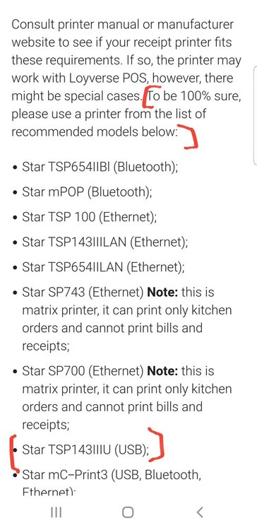

Rudi Posted July 25, 2020 Posted July 25, 2020 (edited) Actually, in the printer setup guide loyverse clearly states that for 100% certainty the USB printers will work then use one of the printers listed. In that list is the tsp143iii usb. I now have the same problem, having checked that it was supported and buying the printer. Now it seems it isn't in fact working. Unless that is suggest as compatible ios printers, which is not super clear if so. Edited July 25, 2020 by Rudi
