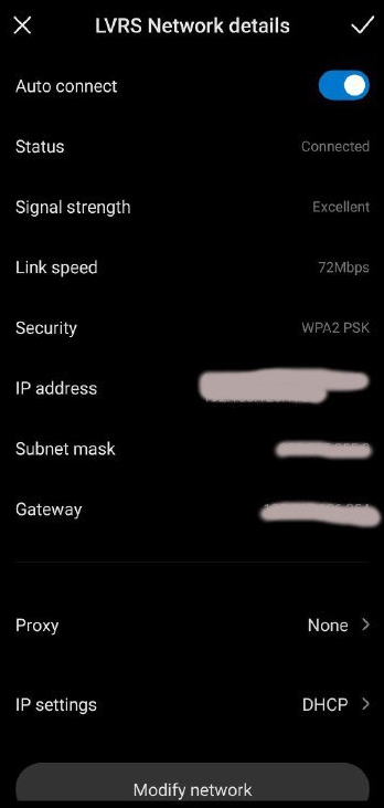

Mag Posted January 23, 2020 Share Posted January 23, 2020 Hi! Can you send the screenshots of Network details from all your devices with POS and KDS Apps? You can also check with your network provider or administrator if your extender really has an Access Point option. Since the settings may be different, it depends on the device you are using. Example of screenshot: Link to comment Share on other sites More sharing options...
