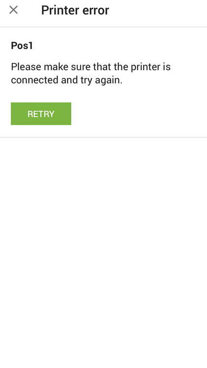

buckethead Posted November 4, 2019 Posted November 4, 2019 Please help how to add printer? what i did is copy the ip address of the router to the add print. But it nothing happens. Picture below was the result when i click the test print

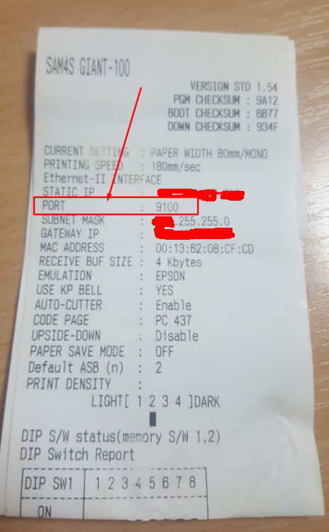

serg_95 Posted November 4, 2019 Posted November 4, 2019 Hi friend. You have to enter the IP address of your printer. Follow this steps to find the IP address of your printer. Turn the printer’s power switch off Hold down the FEED button located on the front of the printer While continuing to hold the FEED button down, turn the power switch on The lights should flash for a few seconds, and then one or two pages should print out with a configuration report You can now release the FEED button You can find the IP address of your printer under the "Current IP Parameters Status" section (underlined by orange below).
Solution Mag Posted November 4, 2019 Solution Posted November 4, 2019 Hi! Please be sure that the port of your printer is 9100. How to change, please check the manual of printer or manufacture. 1
buckethead Posted November 5, 2019 Author Posted November 5, 2019 19 hours ago, Mag said: Hi! Please be sure that the port of your printer is 9100. How to change, please check the manual of printer or manufacture. Yes sir it works. Thank you very much. Hehe

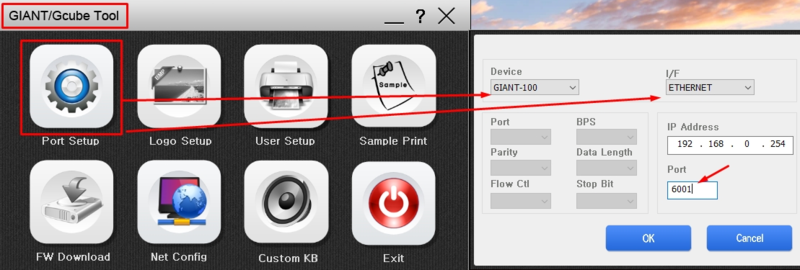

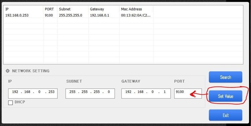

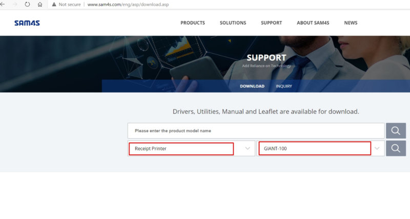

Erich Posted December 1, 2020 Posted December 1, 2020 9 hours ago, Mauricio G said: This does not work for Sam4s 100 Hi, please try the following steps: 1) Enter the website of the printer manufacturer www.sam4s.com/eng/asp/download.asp 2) Select the required model Sam4s 100 3) Install on PC Integrated Utility for GIANT & Gcube 4) Run utility and change port settings 2

juiceboxtkt Posted September 24, 2021 Posted September 24, 2021 On 12/1/2020 at 2:45 AM, Erich said: Hi, please try the following steps: 1) Enter the website of the printer manufacturer www.sam4s.com/eng/asp/download.asp 2) Select the required model Sam4s 100 3) Install on PC Integrated Utility for GIANT & Gcube 4) Run utility and change port settings 5) Change PORT in Net Config...
