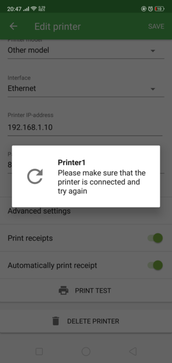

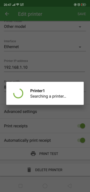

Hassan Posted September 20, 2019 Posted September 20, 2019 Kindly assist we can't print reciepts anymore..... Network printers connected well and are printing from other applications. I look forward to your assistance and cooperation. Hassan
Mag Posted September 20, 2019 Posted September 20, 2019 Hi! Please check the article about Trouble shouting of Ethernet printer https://help.loyverse.com/help/troubleshooting-when-setting. Also, please check that in your printer has port 9100. Lets do that steps and let us know the result
Hassan Posted September 21, 2019 Author Posted September 21, 2019 Thanks Mag for the prompt response, port 9100 is active. I have gone through the trouble shooting guide all seems in order however the printer still failed to print Kindly note the printers are working with other applications and are accessable by all devices. Could it be a technical issue from loyvrse end. Are other users experiencing similar issues? I look forward bro your response thanks.
Mag Posted September 21, 2019 Posted September 21, 2019 Hi! No, other users do not experience similar problems in the moment. Please note, that we can guarantee proper work with printers from the list of supported printers https://help.loyverse.com/help/supported-printers. If you use other printer, it may also work with Loyverse App, but we cannot guarantee that for 100% . Please check requirements for other printers https://help.loyverse.com/help/how-set-other-printers-loyverse-pos The main requirement is that the printer has to support ESC POS commands.
