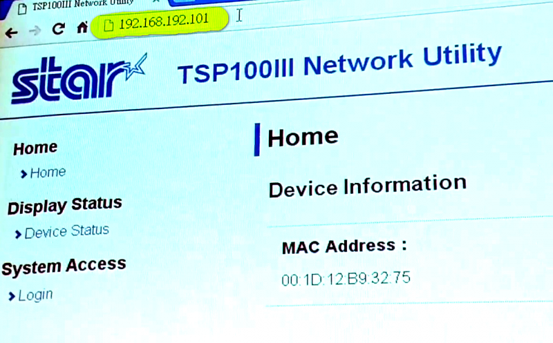

Finding the printer's IP address
Turn off the printer.
Press and hold the feed button.
Turn the printer back on.
Continue to hold the feed button until the Network Configuration report prints out.
Find the printer IP address. In my case, it has the last value: 192.168.192.101

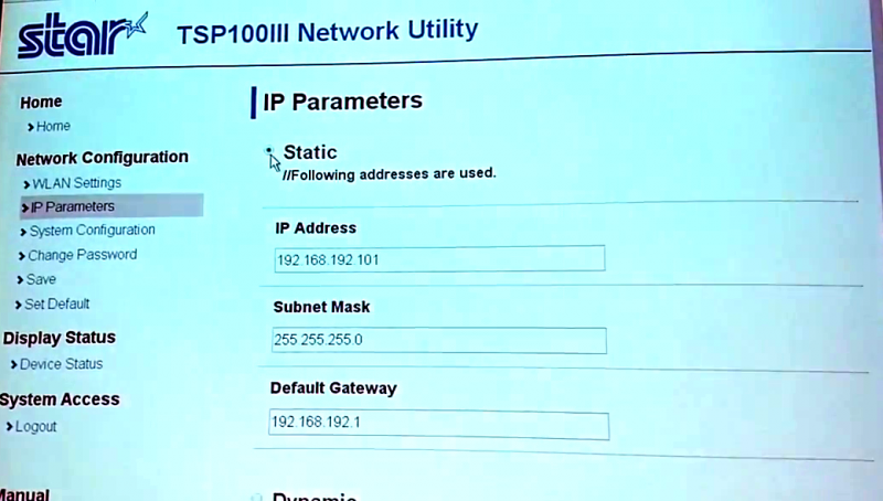

Setting the Static IP
    1. Open your web browser and type the printer's IP address into the URL field
 2. Log into the Network Utility using these credentials; User: root Password: public (if there is a need).
 3. In the left side menu click IP Parameters and select static. The current IP address  and subnet mask should autofill in.
If necessary, enter the desired value in the IP address field.
4. Click Submit
5. Select Save on the left side menu. Chose the option "Save => Configuration printing => Restart device" then click Execute.
The receipt printer should restart and print a new configuration report with Static next to the IP address instead of DHCP.
