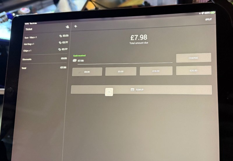

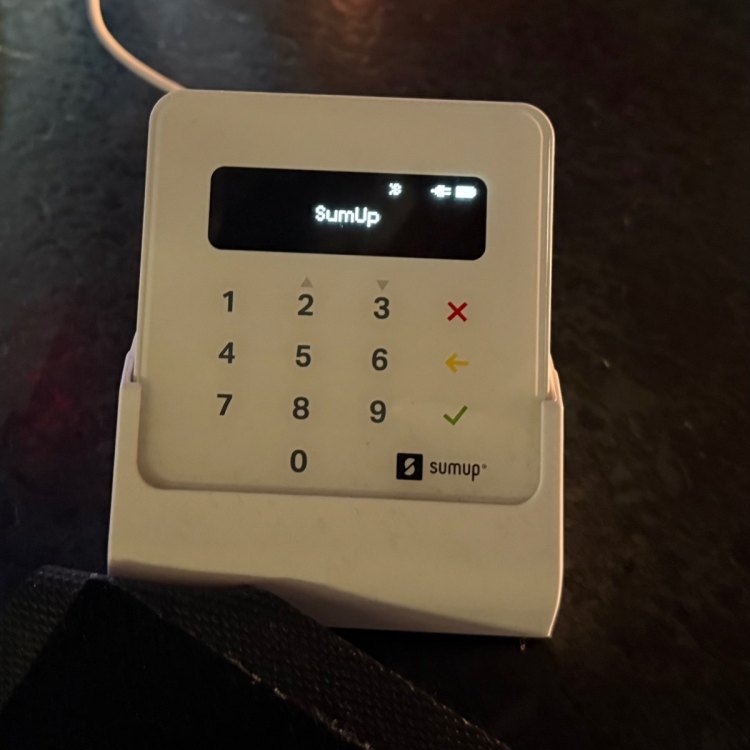

LoyUser Posted January 17, 2025 Posted January 17, 2025 Most of the time - our SumUp / iPad Pro works fine. But some times - after you’ve clicked accept payment with SumUp, you just get a spinning wheel, and nothing happens. The SumUp card reader shows no issues - Bluetooth connected, etc The IPad - has WiFi, and Bluetooth. Connected to the SumUp card machine. Can anyone offer any help on what the issue could be? Or - what steps to take when this happens to reset the process to complete the sale. Many thanks.

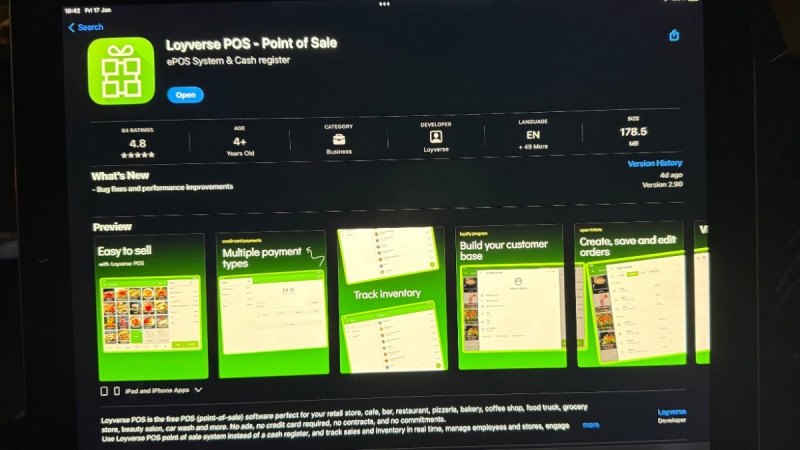

Shinjin Posted January 17, 2025 Posted January 17, 2025 Hello, Could you please update the Loyverse POS app version on your device to v.2.90 and then check if your issue persists. We will be waiting for your feedback.
LoyUser Posted January 17, 2025 Author Posted January 17, 2025 I’ve just checked - and we are running 2.90 Still got the issue. Any idea what it is most likely to be? and we can start trying to go through them and working it out. many thanks.

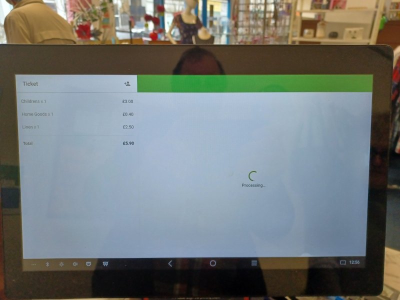

NewHopeCharity Posted January 19, 2025 Posted January 19, 2025 I'm having the same issue as LoyUser, occasional credit card transactions hanging (Loyverse. SumUp v2.99 Loyverse v2.48 on Android 7.1). The only remedy is to restart Loyverse but the sale is lost. Often after around a 2-3 minute delay (that's a long time when you have a queue of customers!) a generic error message appears, click OK and the transaction completes. This is volume related since our second quieter till does not exhibit this behaviour and I have swapped the tills around to eliminate software/hardware/setup... which are identical BTW.

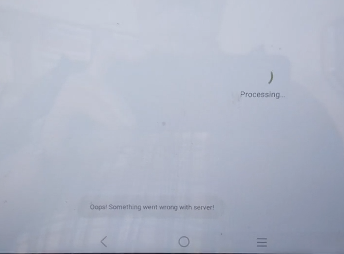

TonyO Posted September 17 Posted September 17 Subject: Server Error with SumUp Integration Message: • Problem: Loyverse returns error {"service":"app-server"} when attempting SumUp payment. • Device: SumUp Solo (paired by Bluetooth) — Solo works and can take payments directly in the SumUp app. • Android device model and OS version: [insert model & Android version] • Loyverse app version: [insert version] • SumUp app version: [insert version] • Steps already tried: restarted both devices; cleared Loyverse cache; disabled battery optimisation; reconnected SumUp in Loyverse; verified Solo powers on and processes payments in SumUp app. • Time(s) error occurred: [insert local date/time] Please investigate the SumUp integration or server-side issue causing the error.
martock Posted September 17 Posted September 17 i am having the same issue with the server error on sum up payments it works once ok then the next payment the server error comes up and the app is then stuck in a loop.. i have updated loyverse today still no change ..please advise

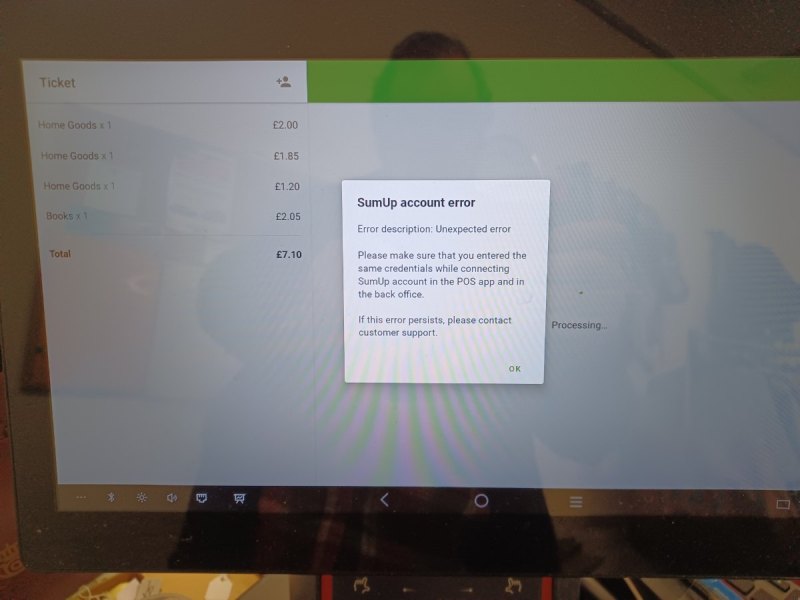

NewHopeCharity Posted September 17 Posted September 17 Reinforce barrgrill, TonyO and martock. About every other SumUp card payment gets stuck in "processing" and never returns. Have to kill Loyverse, loose the Ticket and restart. You don't allow video so the attached is a screenshot of the important error message. This occurs the instant one clicks Card for the payment. SumUp deny any issues at their end though there was recognition posted on their Status site yesterday but nothing today. Any suggestion ShinJin? (Loyverse 2.74, SumUp 2.135.0, Andoird 9.0 in Sumni T2s terminal)
