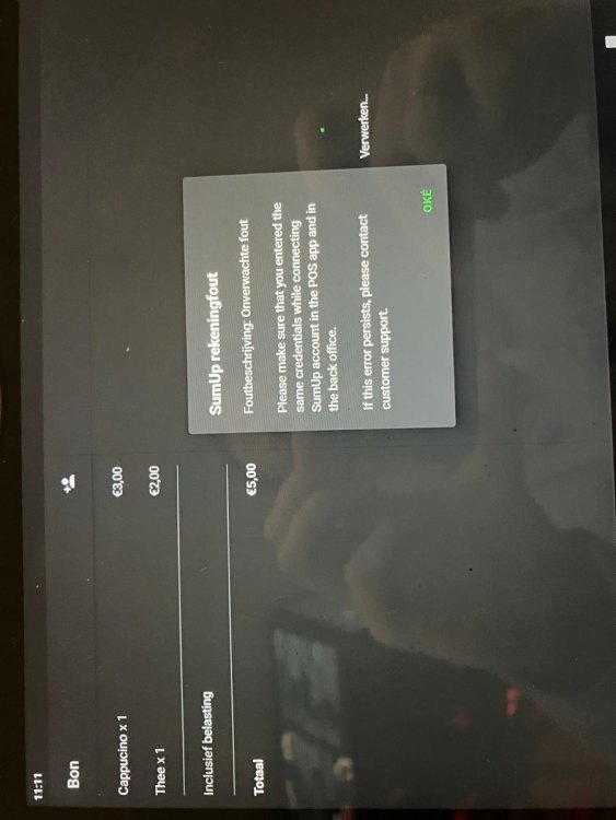

Stal_Groenendaal Posted January 4, 2025 Posted January 4, 2025 I'm a bit further with finding a problem. Today around 12:00 on 04-01-2024 we had a error. It gives a error and says that there there is a SumUp calculation error. And I must assure that the credentials in SumUp and Loyverse are the same. We have have two different account for sumup. 1 is the owner and 1 i use on the POS tablets it self. Due the fact that the owner account has to much rights in SumUp to let that being used on the tablets because we have a lot of different clerks behind the bar. The strange this is that we have being using different account all the time. So why is this now a problem? A positive this is that the payment is correct registerd in sumup. loyverse and is send to the kitchen. When Pressing on oké we could just keep going using the app as normal. This error is on a android device.
