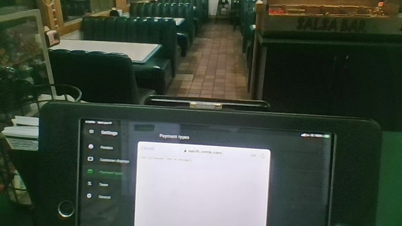

TaqueriaLaEstrella Posted January 18, 2024 Posted January 18, 2024 I have the same issue and obvious;y many other do too. I contacted paypal and everything is okay on their end...I need zettle working...sumup is too slow for the drive thru
