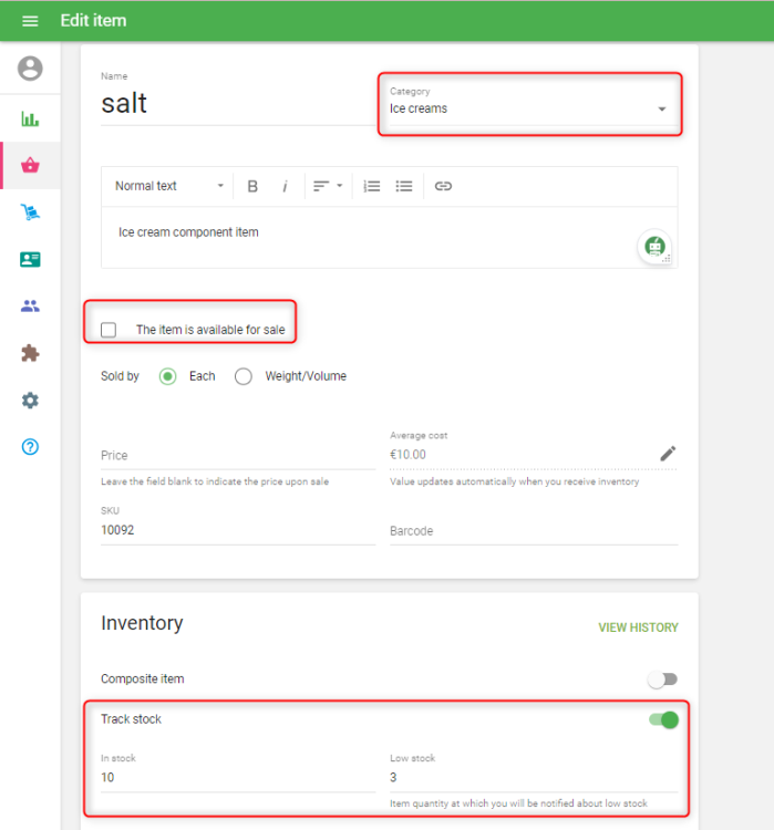

First, you need to create theindividual components and the main composite  item that will be added as a component later and create its own category to sort out the items.

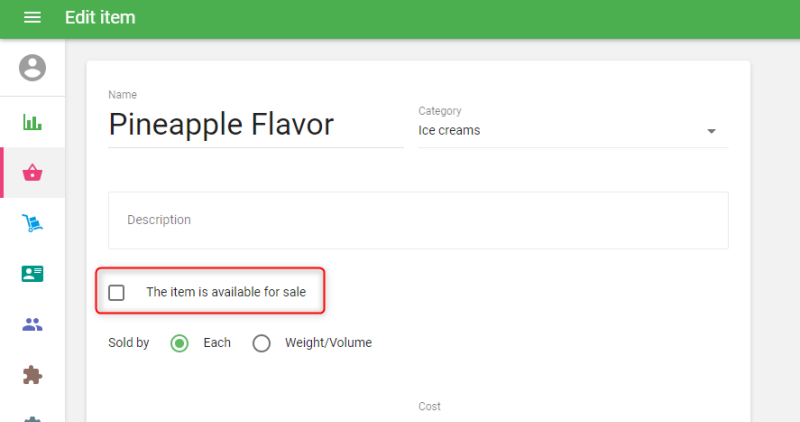

With this example, I created my items with the main ingredients first.For the main ingredients, you can either make them available for sale for not make them available for sale in your POS app.

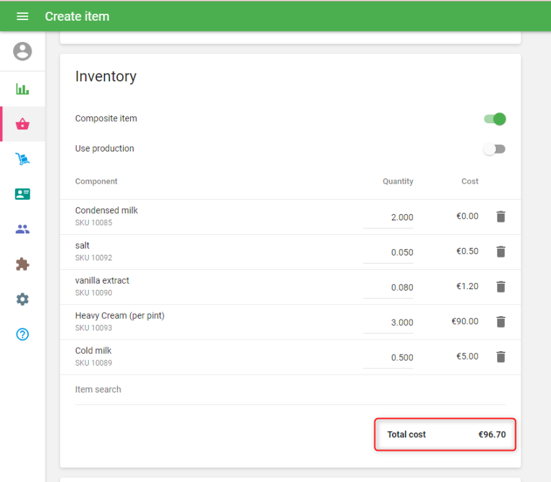

After creating all main ingredients of the ice cream, don’t forget to activate the track stocks of the individual items and afterwards, you can merge the items to be a composite item. You need to add the quantity of the items converted into decimal points at the end of this, you will see the combined cost below.

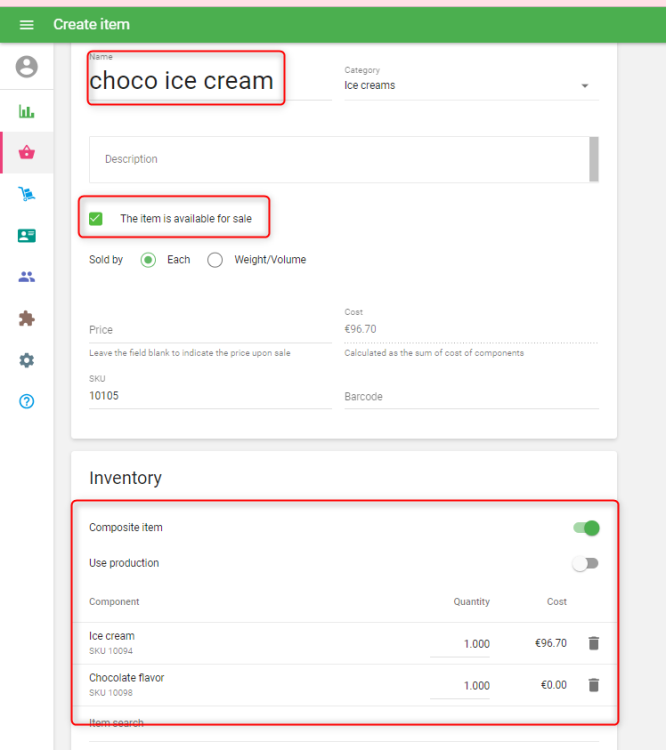

And then, after creating the main item, let proceed to different flavors.
With this, you also need to add the individual items for the flavors. For example: strawberry, mango, chocolate, etc and don’t forget to activate the ‘track stock’ if needed.
After adding the flavor and the ice cream item, you now have a chocolate flavor of ice cream. Afterwards, you can use the same method to add different flavors.

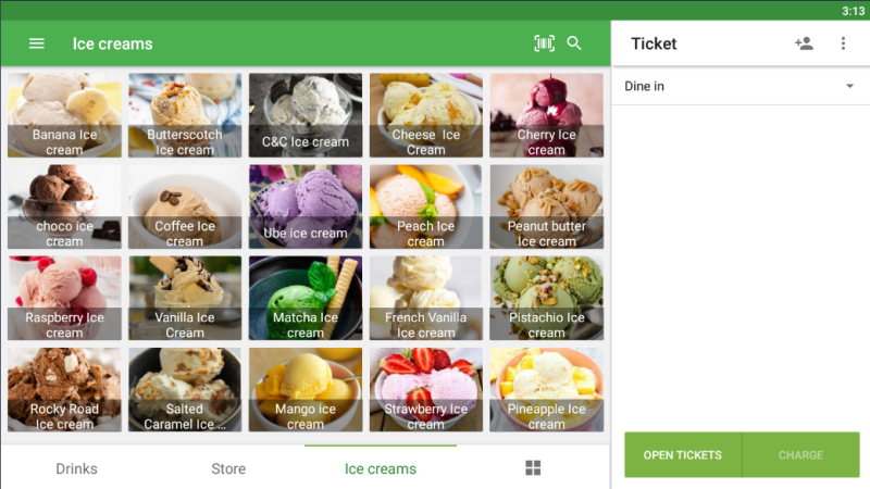

After creating all the ice cream flavors, you can sort the iteams in your POS app by customizing them in a table/iPad screens, you can also rename the title bar as ‘ice cream’. In my case, I created 20 flavors without reaching the nesting level. So each time I sold any ice cream the stocks will be deducted to the flavors and main stocks that was added in the components of each flavor
