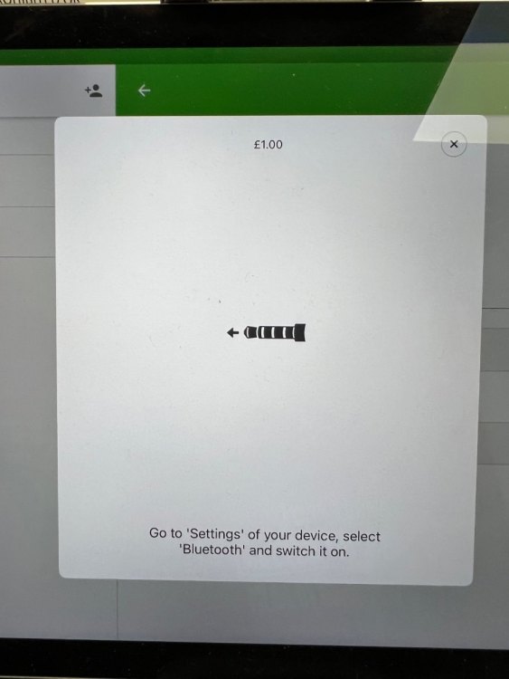

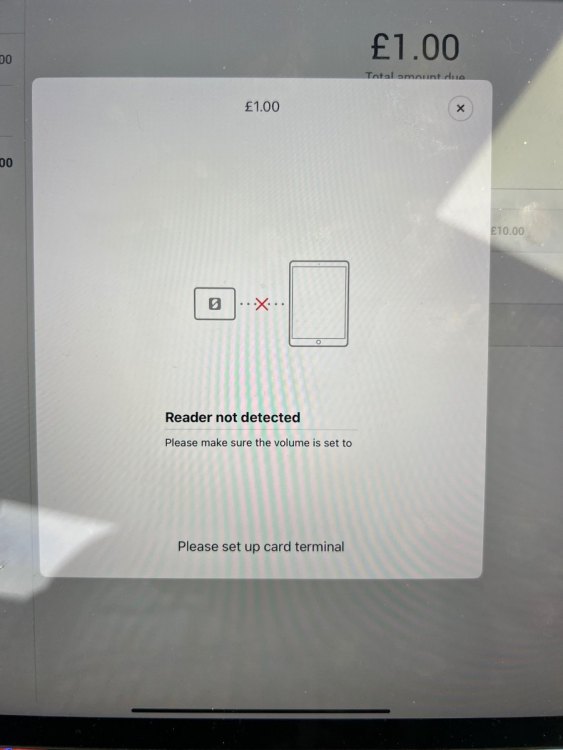

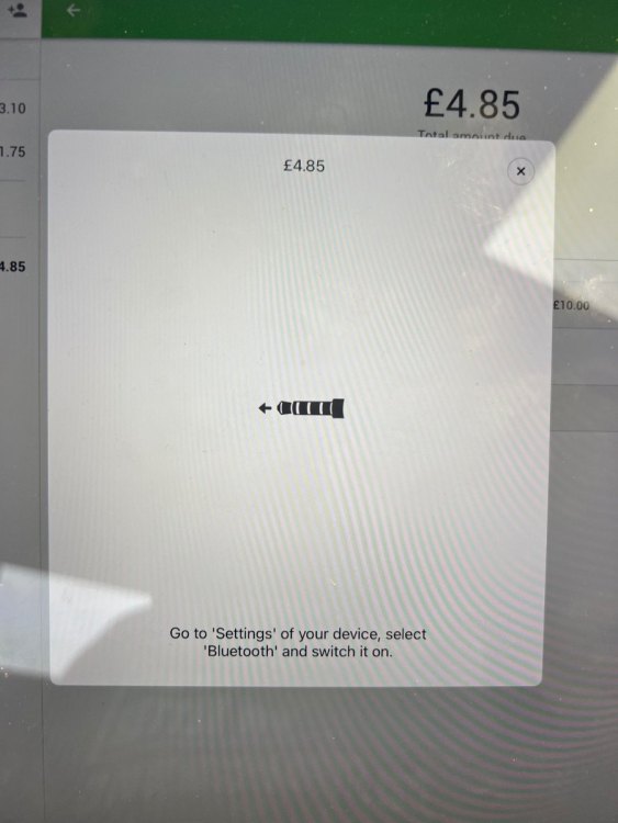

Standtheman Posted June 29, 2023 Posted June 29, 2023 This is strange... we are using 3 iPads and 3 sumup devices. They are located in different areas of the shop (not next to each other). We've been using this setup for about 2-3 years if not more. Today, a strange issue is happening, the sumup devices have been disconnected, and a message is coming onto the loyverse screen asking us to turn ON the bluetooth. But the bluetooth is turned ON. Our barcode scanner is bluetooth and is working good. The other strange thing is that the message appearing on screen is different on each iPad. The devices are working with my separate sumup app on my phone. So I do not think the issue is with the devices. Like I said. It's 3 different iPads and 3 different sumup devices. I have tried removing the loyverse app from one of the iPads, and re-installing it, I have tried removing the sumup payment option from back office payment types and also tried logging out and back in again, and even tried resetting the sumup devices. Nothing works. So I'm guessing there is an issue either with one of the API's loyverse or sumup, or the loyverse programming connecting to the iPads bluetooth functionality.
Shinjin Posted June 29, 2023 Posted June 29, 2023 Hello, Thank you for your post. The messages visible on the screen after selecting Sumup as the payment type are sent by Sumup. Have you already tried contacting Sumup support?
