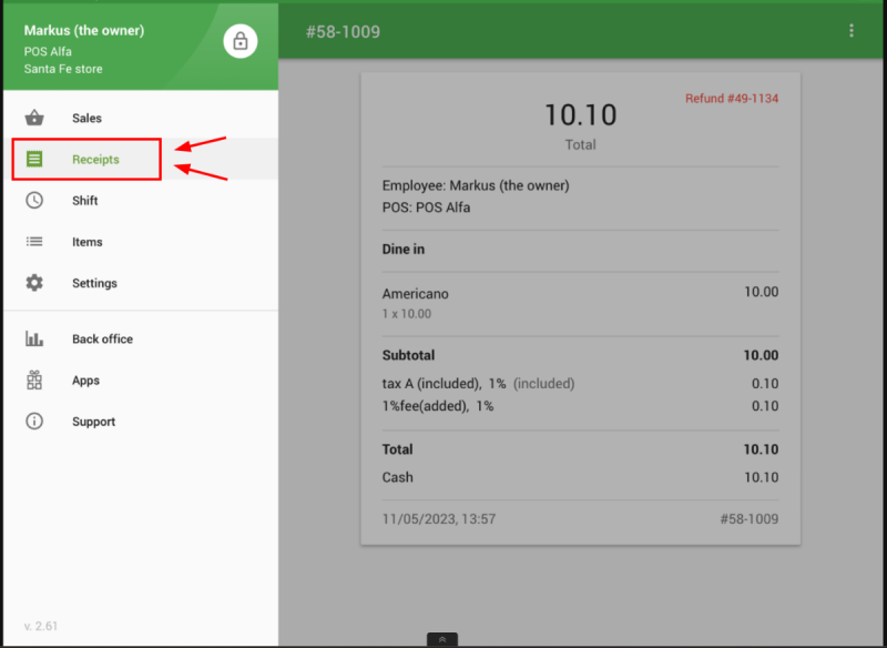

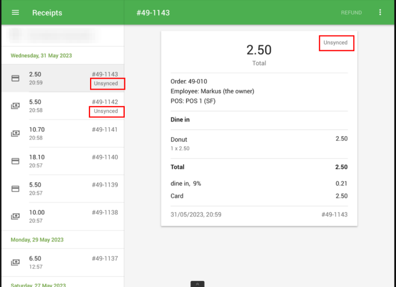

4.Please, check if the missed receipts are displayed in the RECEIPTS section on the POS device where these receipts were made.

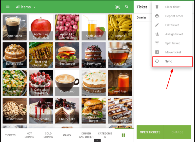

If the receipts are shown there and marked as not synchronised, please press SYNC button on the sale screen:
image.png.493646742dd338ee235275637c50cfb3_1.thumb.png.b89f22df70877e69baf1c8f66cb6bb1a.png
