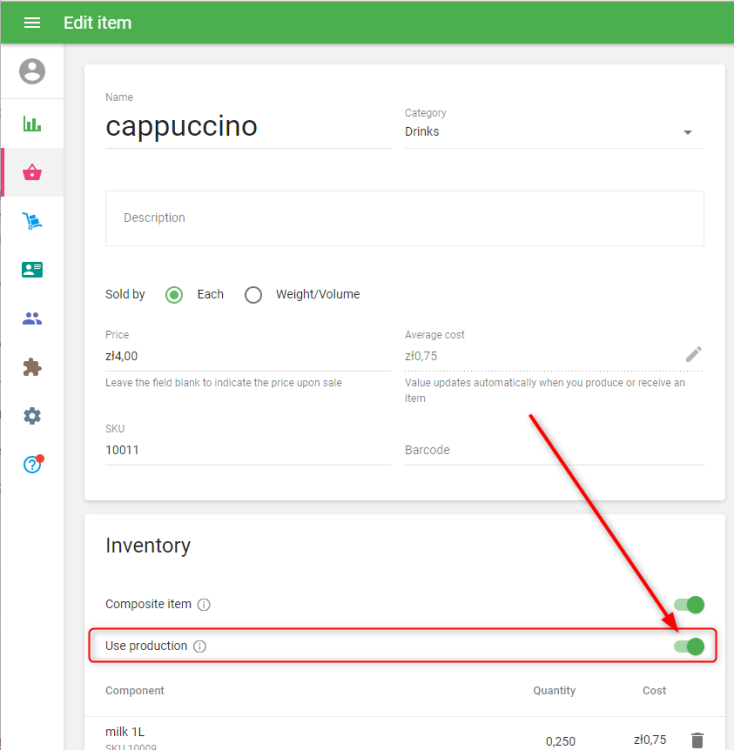

Hello!

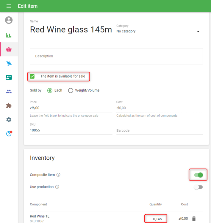

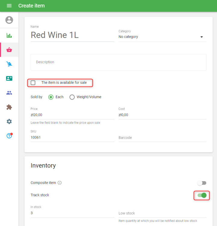

In this case, I can suggest you create one main item "Red Wine 1L" (not available for sale) with stock tracking option enabled, which will allow you to see all the calculations of how much of this item has been sold, purchased.
All the other items: Red Wine 3L, Red Wine 5L and Red Wine glass 145ml will be composite items with Red Wine 1L as component.

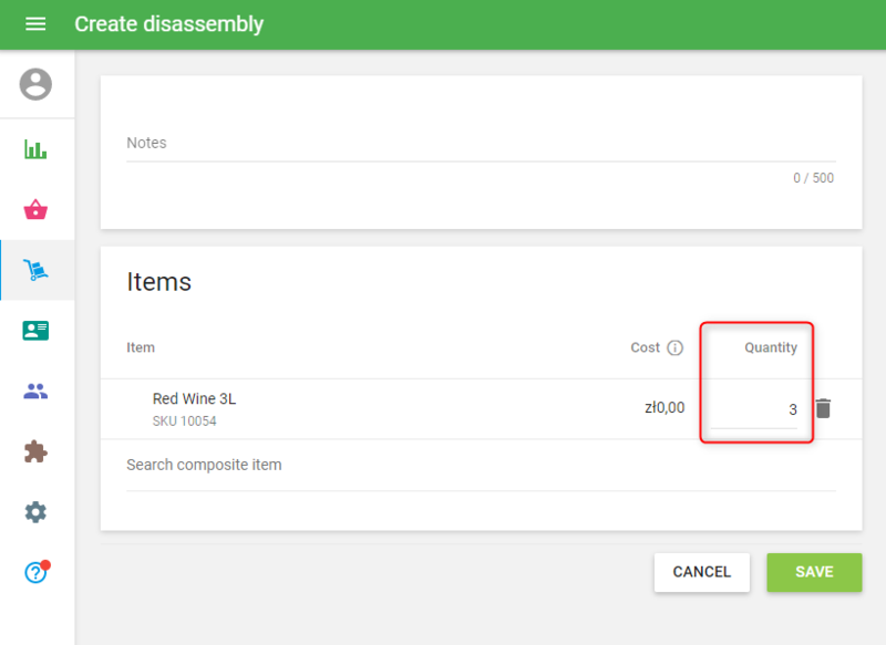

Now you need to create them. For the Red Wine glass 145ml, you need to activate "composite item", add the Red Wine 1L as component with quantity 0,145.
Each time you will make a sale of wine glass, the stock of the "Red Wine 1L" will decrease for the quantity which was sold.
For item Red Wine 3L in the quantity field you need to input 3,000 and for the Red Wine 5L - 5,000 and enable "production" option.

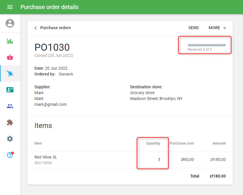

Now when you will make a purchase order for item "Red Wine 3L", you need to input how many cases you want to order and receive it.
After that, you need to create disassembly for the item "Red Wine 3L", meaning if you ordered 3 cases of that item, you need to input "3" in the quantity:
The "in stock" value of item "Red Wine 1L" will change after making a disassembly.

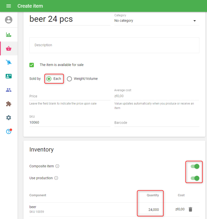

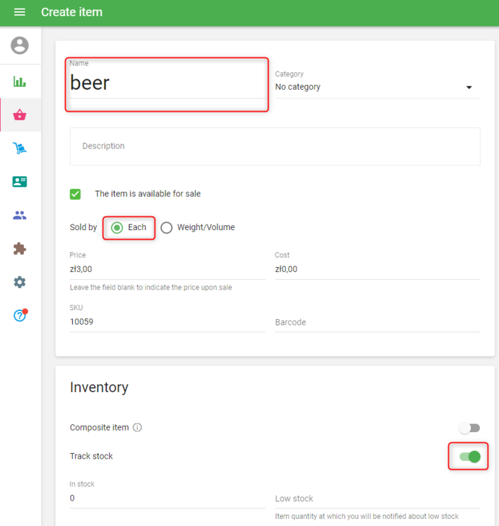

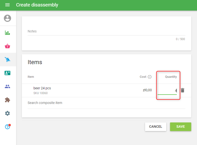

Now for the beer case:
First, you need to create item beer (sold by each, track stock enabled)
Then you need to create item beer 24 psc (this item will be used to order by boxes). Make it composite with quantity 24 (the number of beers in case) with production enabled:
Now you need to make a purchase order for item "beer 24 psc", input how many cases you want to order, receive the purchase order. The last step is to create a dissasembly for that item, meaning if you ordered 4 cases of that item, you need to input "4" in the quantity:
After that, the stock of "beer" will be automatically updated.
