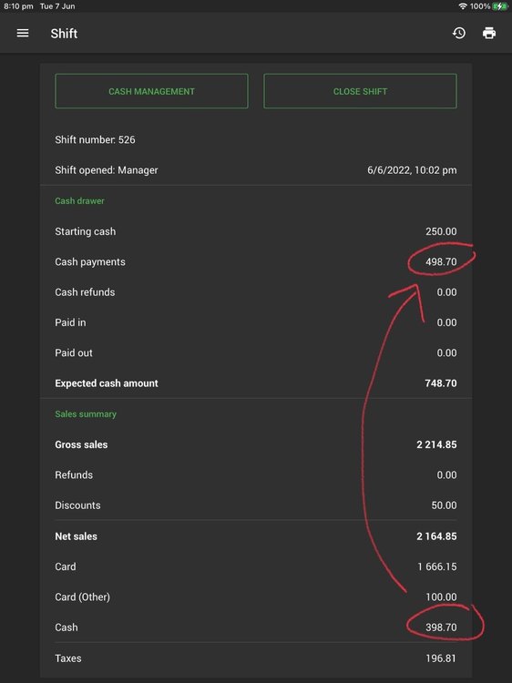

When customer split their payment into Cash and Credit, the whole amount is added to total cash payment which make the Expected cash amount to be not balanced when closing shift.
When customer split their payment into Cash and Credit, the whole amount is added to total cash payment which make the Expected cash amount to be not balanced when closing shift. However, the Credit is fine just the Cash part.
Could you please tell me how to fix this problem as I got this problem since last week and it starts to annoy me everytime that I close the shift and has no idea where the cash missing.

Could you be able to give us an example or atleast a screenshot of printed shift report from your shift history in the POS App that shows a discrepancy in the cash part like you mentioned? Also, which exact POS is this happening? Can you tell us its POS name?

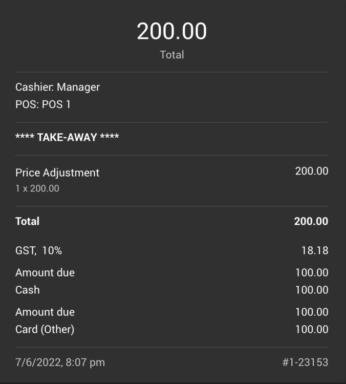

Please see the attachments for the example. Customer split payment into cash and card. Each is $100. However the total cash payment is $100 over as it added another $100 from card payment into that as well.
The POS is POS 1.
Edited by PongTana
I see, thank you for sending us the information. I'll have this be checked by our team.
