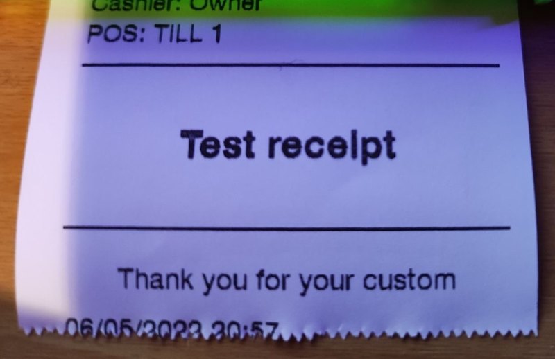

sherpa Posted May 6, 2022 Share Posted May 6, 2022 Hi, Have just purchased a sunmi d2 mini cash register and have everything set up how i like it, the only problem i am having is that when receipts are printed the time and date are in the cut off area is there a setting i can change so this dose not happen please? Link to comment Share on other sites More sharing options...

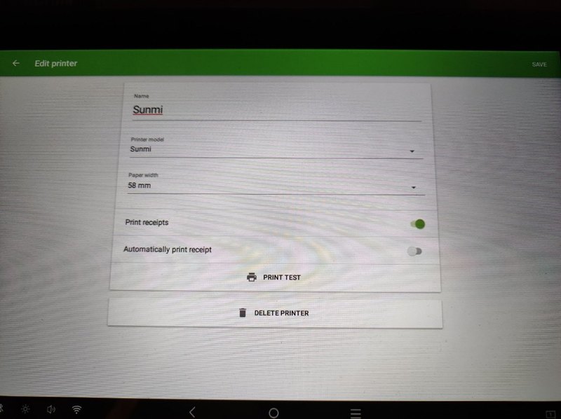

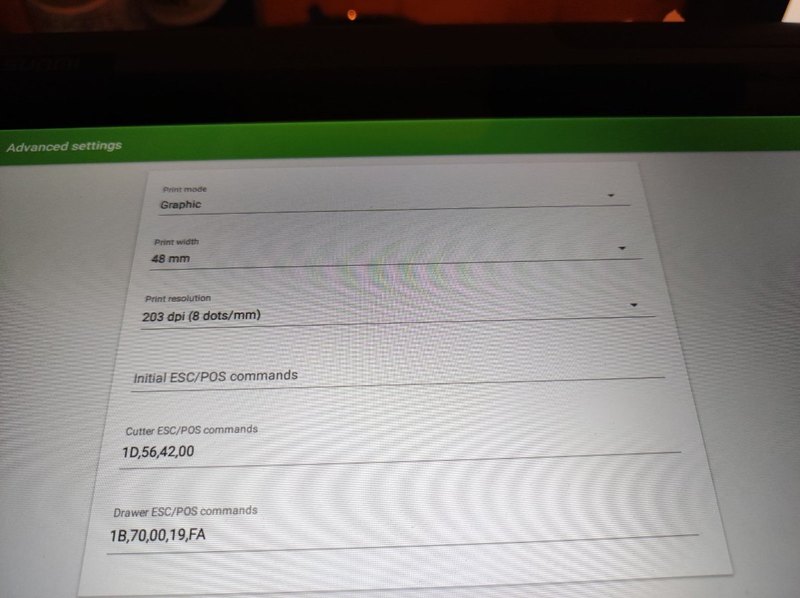

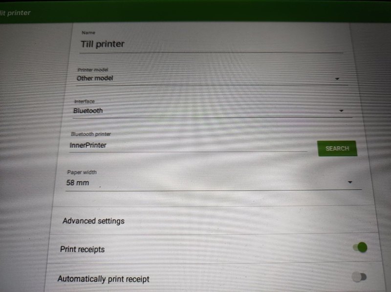

sherpa Posted May 10, 2022 Author Share Posted May 10, 2022 On 5/9/2022 at 6:44 PM, Georg said: Hello Could you make a screenshot of your printer settings in the POS App? Hi, here is a photo of my loyverse printer settings 9 hours ago, Georg said: Did you try to contact Sunmi support team? Maybe they can help you to fix this receipt printing issue. Have tried sunmi customer support and got this reply, "wei zhou Monday 5:51 PM Hello Can you try to add printing blank line command after printing your content? BRs" I have asked them what they mean by printing a blank line command but have not had a answer yet from them Link to comment Share on other sites More sharing options...
CashRegisterGroup Posted May 10, 2022 Share Posted May 10, 2022 i think they mean adding a blank line in the footer - but that doesnt work. basically the fix would be a command code in the advanced settings - however no one seems to be able to provide it Link to comment Share on other sites More sharing options...

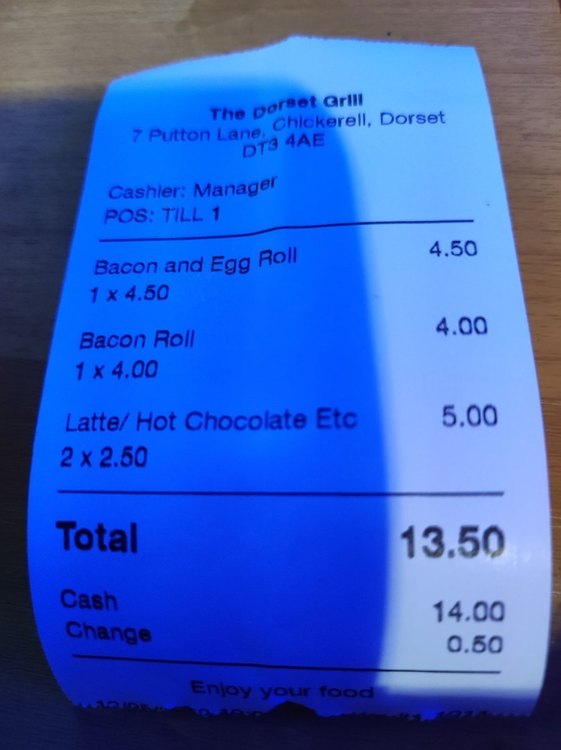

sherpa Posted May 12, 2022 Author Share Posted May 12, 2022 1 hour ago, Georg said: Could you send me a photo of the real receipt, please? Hi Georg, I have attached a real receipt from my till for you, this is what happens if i do not pull up on the receipt so that the date and receipt number dose not get cut off Link to comment Share on other sites More sharing options...
CashRegisterGroup Posted May 12, 2022 Share Posted May 12, 2022 (edited) here is a (likely) fix on the printer setup, delete the existing then add a new printer - Name the printer, then in printer model select OTHER MODEL, Select BLUEOOTH and hit search – it should come back as INNER PRINTER. Select the correct width (based on model). Then open advanced settings – in the field called Cutter ESC/POS Commands overwrite this with 0A0A0A1D564200 – Hit back. and hit print test – hit save in the top corner. Edited May 12, 2022 by CashRegisterGroup Link to comment Share on other sites More sharing options...

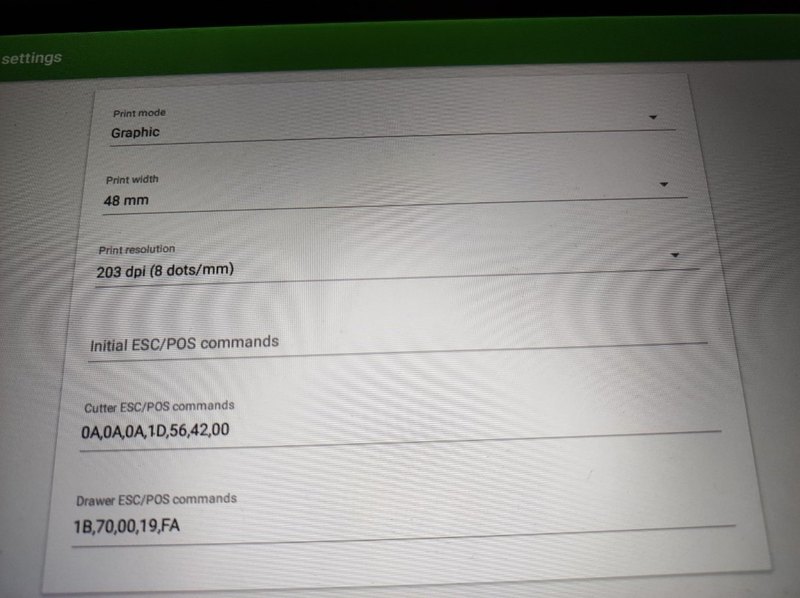

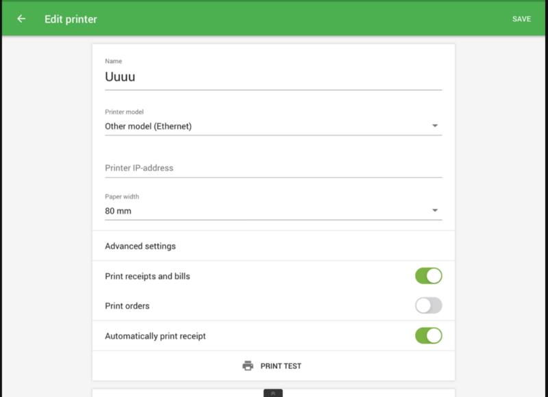

sherpa Posted May 15, 2022 Author Share Posted May 15, 2022 On 5/12/2022 at 8:54 PM, CashRegisterGroup said: here is a (likely) fix on the printer setup, delete the existing then add a new printer - Name the printer, then in printer model select OTHER MODEL, Select BLUEOOTH and hit search – it should come back as INNER PRINTER. Select the correct width (based on model). Then open advanced settings – in the field called Cutter ESC/POS Commands overwrite this with 0A0A0A1D564200 – Hit back. and hit print test – hit save in the top corner. Thank you for you solution to this, Have tried you Fix and it dose make the printer work correctly now, the only problem i have now is the cash draw will not open when i make a sale. I have attached photos of the changed settings i have got now are this correct for the cash draw as well? Also the third picture is what was the original settings before i changed anything Thank you for your help in this matter sunmi customer support have bin useless so far Link to comment Share on other sites More sharing options...
CashRegisterGroup Posted May 16, 2022 Share Posted May 16, 2022 yep setting look correct. i've tested again here and the drawer is being kicked as expected (ie on a cash sale). what version of Loyverse are you running? for reference we are on v2.22.9-sunmi also which Sunmi d2 model is it? Link to comment Share on other sites More sharing options...
