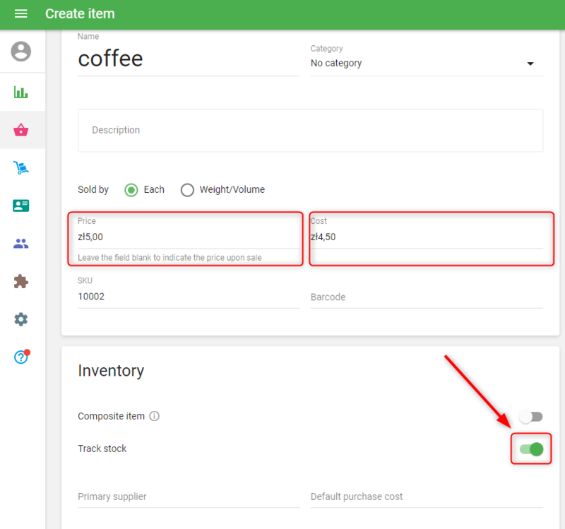

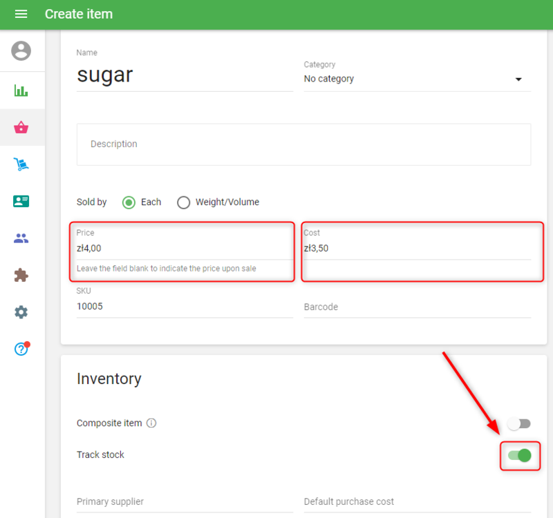

At first, you need to create items coffee and sugar, set up price and cost, activate "track stock" option  for each of them.

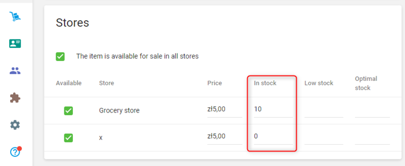

After that, you will be able to indicate the number of coffee and sugar you have in stock.
