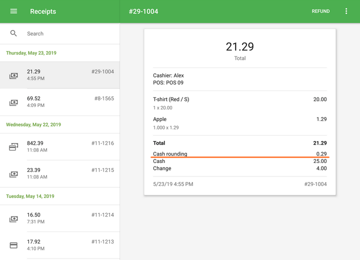

The Cash Rounding will show in a receipt after the total amount of the purchase as shown in the picture provided to notify the customer that a round off of this amount has been made in their payment:

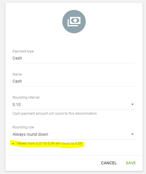

If you want to be able to set your rounding off to that number as specifically stated by your example, then what I can suggest is that in your rounding interval, set it to 0.10 then in its rounding rule, set the rule to "Always Round Down". That way, values from 0.01 to 0.09 will always round to 0.00.
That way, if you round off $74.39, it will become $74.30.
