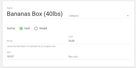

First Step: Creating item box.
Indicate in the item’s name your unit of measure. In my example I write "Bananas Box (40lbs)"; and give it a cost.

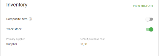

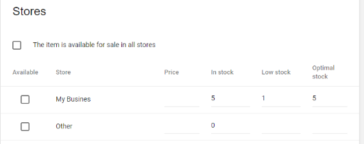

Enable Track Stock, and enter a stock value.
Note that the sotck means how many boxes you have in inventory.
1 unit in stock equals 1 box in inventory, which means 40lbs of bananas.
2 units in stock = 2 boxes = 80 lbs
You can now also specify a low stock and an optimal stock value. This will help later to create a purchase order.
In my case I will also enter a supplier and a default purchase cost.

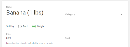

Second step: Creating Unit Item.
In this case, I will indicate in the item name my unit of measure, which will be 1 lbs.
I enter the sales price, but I leave the cost field empty. In my example I sell this item by weight.
We are not going to track stock.

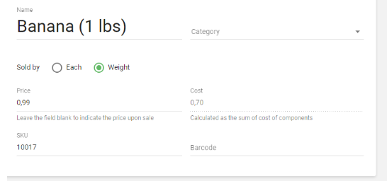

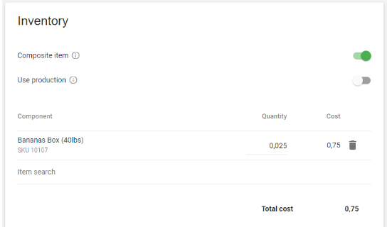

Instead, we activate “Composite item”
In the component search, add the item “Bananas Box”
And enter 0.025 in the quantity column.
The unit cost will be automatically calculated. (0.75 as shown in the image above)
The formula for the quantity I used is 1*1/40
It comes after considering that 40 (lbs) makes 1 box. So we need to calulate how many boxes makes 1 (lbs).
1 lbs makes 0.025 boxes.
After that, we only need to save the changes.

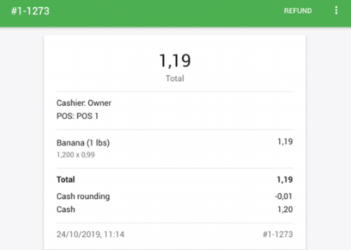

Next: Selling items
Now, I head to the POS and proceed to make a sale of Banana x 1.200
Stock of item box is reduced the respective units. Which should be 1.2 * 0.025 = 0.03
The result is that I have 4.97 units in stock

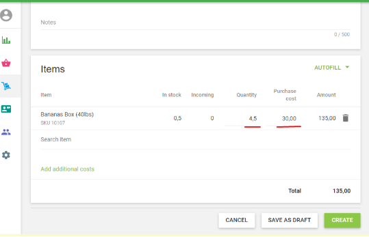

Next: Creating new Purchase Order
Let’s say the stock of the box drops down to 0.5 units.
Now I want to make a Purchase Order.
Quantity and Purchase cost are automatically filled based on my current stock level and the Low and Optimal stock.
Probably it’s not convenient to order 4.5 boxes, but rather, 5 new boxes.

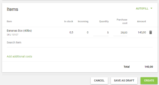

And this time, my supplier is giving me a better price of $28 per box. So I will manually change the values.
The goods arrive to store so I mark the order as received.

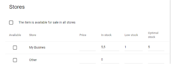

I check the item and confirm that the stock is updated:

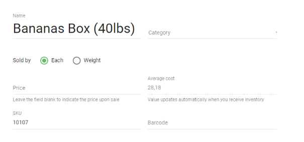

And I can see how average cost has also been updated
The cost of the unit item also gets updated accordingly.

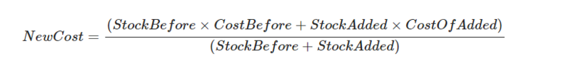

The formula of how the new average cost is calculated is the following:
