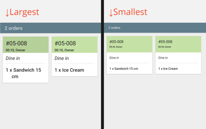

Yes, as @Jeck mentioned, you can increase the font of the Loyverse KDS from the Android settings.
Go to the settings of your phone and search for the option to change the Font size of your device, this way the KDS will change the font size accordingly. This also applies to the POS application, you can refer to this article: https://help.loyverse.com/help/how-change-font-size
