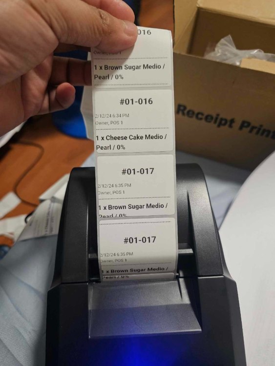

doubleo2023 Posted February 13, 2024 Posted February 13, 2024 On 6/16/2020 at 2:20 AM, jack.li said: Dear everyone, Loyverse POS currently doesn't support splitting kitchen order into one item by one item, maybe loyverse team will update APP in future, before that , EastRoyce ( professional printer manufacturer and developer) has a compromised solution for bubble tea shop or milk tea shop to print Kitchen label one by one when customer orders more than one items , and paste it on the cup. Please watch this youtube video and description carefully. how to do it? i have a problem aligning the sticker paper

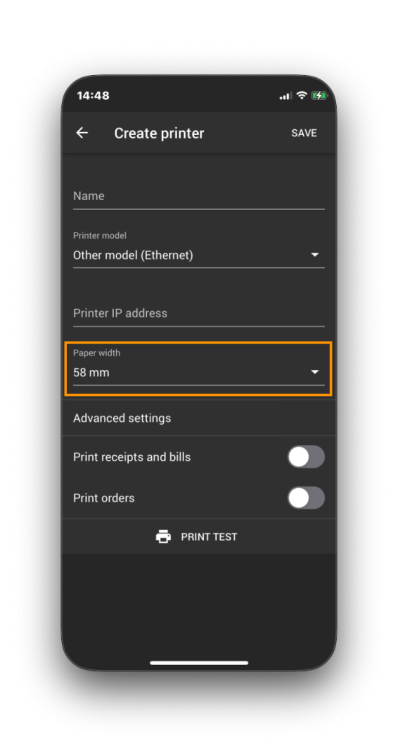

玉城真二郎 Posted February 13, 2024 Posted February 13, 2024 4 hours ago, doubleo2023 said: how to do it? i have a problem aligning the sticker paper Maybe you should choose "58mm" paper width.
doubleo2023 Posted February 15, 2024 Posted February 15, 2024 On 2/13/2024 at 4:46 PM, 玉城真二郎 said: Maybe you should choose "58mm" paper width. Hi currently im using 58x40mm sticker paper

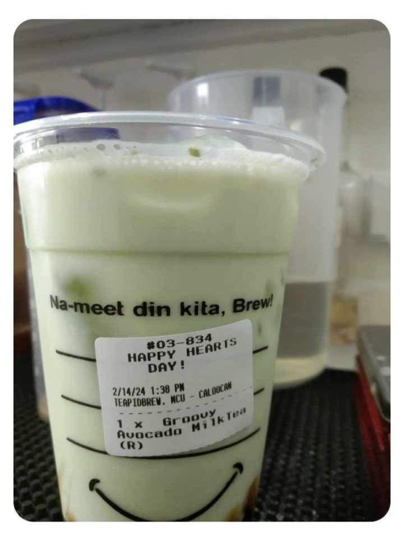

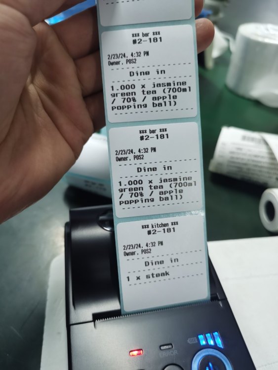

jack.li Posted February 24, 2024 Posted February 24, 2024 Android loyverse and iOS loyverse were updated to support "Print single item per order ticket " for print order function ( kitchen/bar/...). If you are running bubble tea/milk tea/green tea shop, you might have a chance to print sticker one by one for all items in the order and put it on each cup. You could refer to the following videos. 1 1
Tanaka_Shotaro Posted January 6, 2025 Posted January 6, 2025 On 2/15/2024 at 3:08 AM, doubleo2023 said: Hi currently im using 58x40mm sticker paper I think he meant this. .
