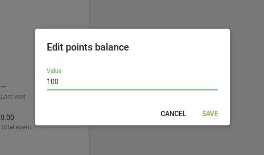

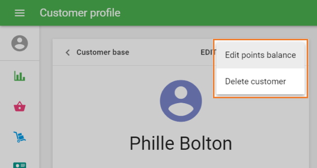

Unfortunately, Loyverse POS does not have the functionality to deal with gift cards, but some workaround is possible.
In the Back office, it is possible to add points to the customer manually. You can create a new customer, let's call it "Gift card 22", assign it a Customer code (which is printed on the gift card).
You can enter new points balance in the pop-up ‘Edit points balance’ form and click ‘Adjust’.
Note, that 100 point is equal to the 1.00 money value.
And when the customer gives you the gift card, you can scan it to add it to the ticket; the points will be redeemed for the assigned discount.
